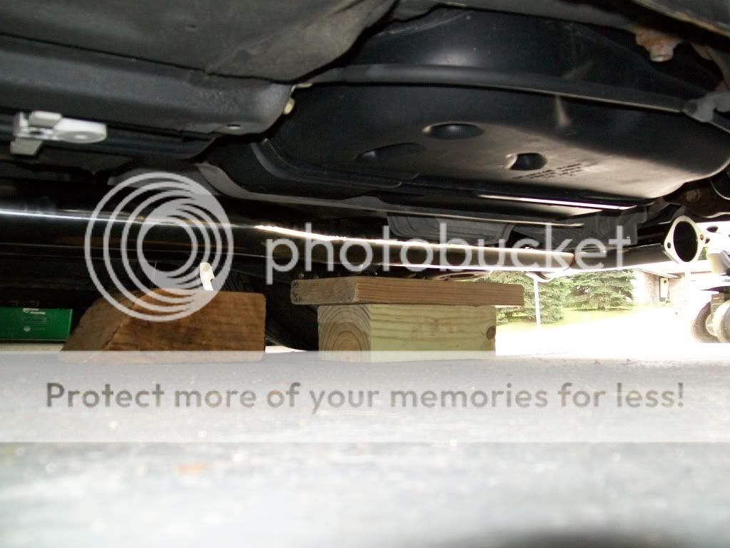

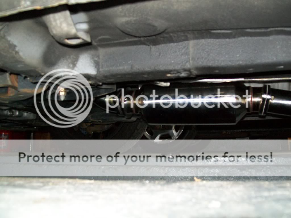

Awesome here are some pics of mine..
ill have the muffler pics on tuesday, they came out blurry and i gotta retake the pictures..
Awesome that looks really good, I'm excited to get mine and hear it in person. The one thing I'm worried about is i hope it doesn't smoke after i install the exhaust, cause i have seen that a lot of peoples do. But seeing as where both of my cats will still be on i think i should be good.
Thanks for the pics
no problem.. with the cats still there it shouldnt smoke if it does look into getting the PTP fix..mine hasent smoked to date with the downpipe on.. im running 5w-40 oil and the fix..

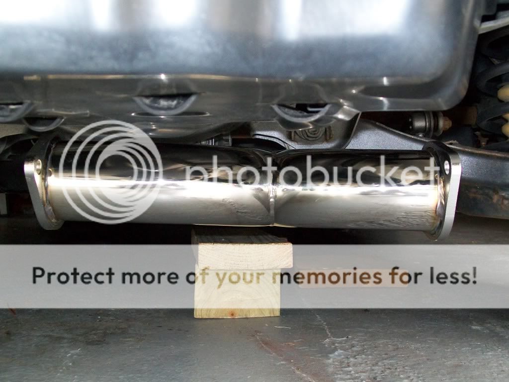

I talked to Corksport today. They are sending a couple of new gaskets out priority mail at no charge. I should have them Friday. They are interested in seeing some pictures of the flanges. I'll try to post up what I send them here as well so you guys can see.
Jason told me today that if the flanges look warped they'll make it right with me. I don't want to assume what that means at this point.
