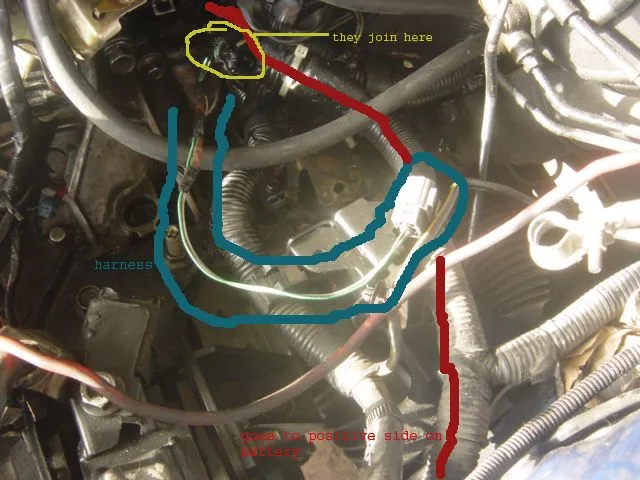

ok i have a problem, on the harness that goes to the power side of the battery there is a gray plug with 2 wires. one is green and the other is gray. anyone know where it plugs into?
Isnt that the one that goes to the starter? Is it big?
couldnt get any before i left houston. let me see if i can my brother to take some pics of it.
LinuxRacr said:
hmm starter you say. the car started up without the plug beigned connected its a small harness.
finally got some pics.
nope not the egr. anyone else? guess tomorrow morning i will have to check again. i am thinking it might be the speedo harness.
yeah it was the speedometer. started the car it idles kinda high, right around 1.5krpms. battery is no good so am thinking that might be part of the problem. i will prolly get a cheap napa brand.
