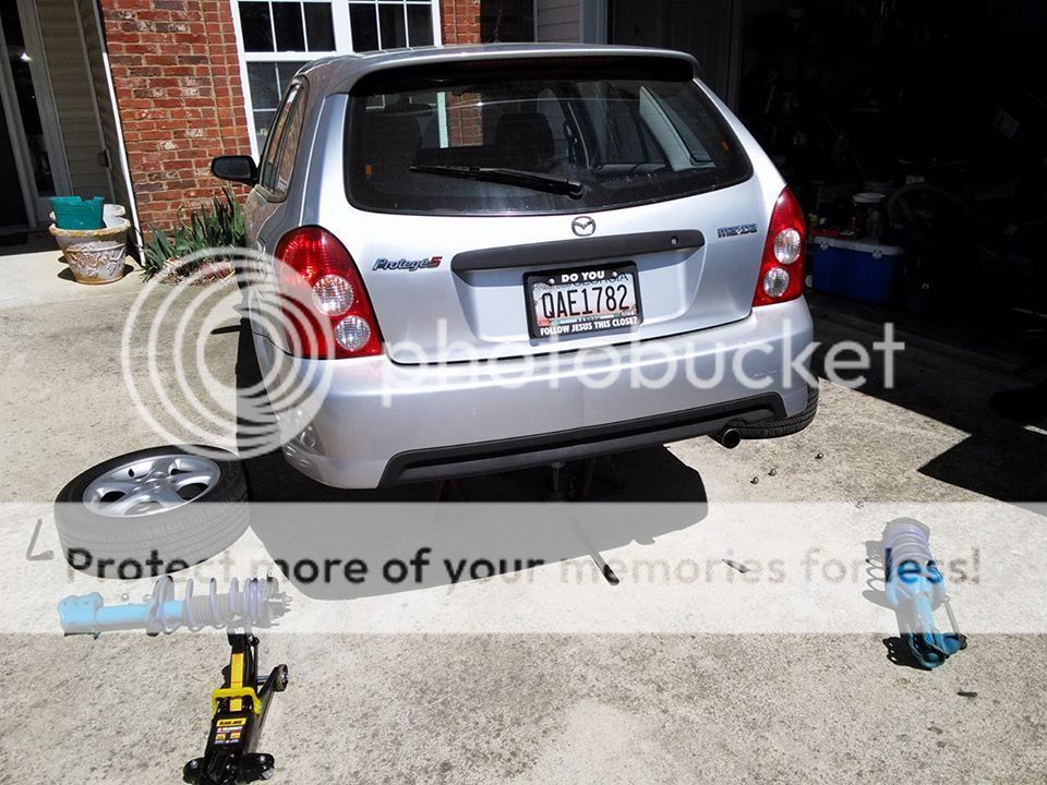

Today I replaced my rotors and installed my Tokico Blue struts and Sprint springs. Thanks Protege99! Didn't take much to clean them up.
Getting started on installing them. Bottom's up!
Here's the final product. Due to some complications with a completely rounded nut it was dark by the time I was done. I passed the shoe test though! (Any other MCM fans out there?)
