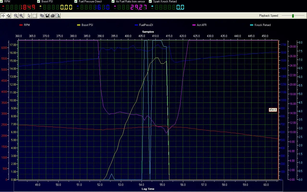

I'm stock except for the Denso ITV22s I put in. I actually have a datalog plot to put up where I hit knock under load on the freeway (doing ~65 in 6th, give it some gas especially when going uphill, knock), it went up to about 8 on the sensor. I also see knock when I'm pulling on hard runs, but that's much lower and only hits right when I shift and only in the higher gears (and I don't feel/notice it). Always was like this even before the plugs.
It's the knock on the freeway that I can hear and feel that makes me worry just a little bit...when it feels like the ABS or traction control is stuttering but it's knock it's not a great feeling...

No, you're probably knocking, that is exactly how I would describe what happens with my car. And, I don't floor it when this happens, I just give it a little gas, but it acts as if I did mash the throttle. It makes me think that the throttle is more sensitive at that point for some reason.
The attached picture shows what it looks like in a Dashhawk log...you can see that the boost went way up even though the RPMs didn't change at all, and I definitely wasn't hitting it when I did this. It would be nice to understand why this happens, whenever I find some time I may try datalogging this some more and see if I can make some sense of it.
