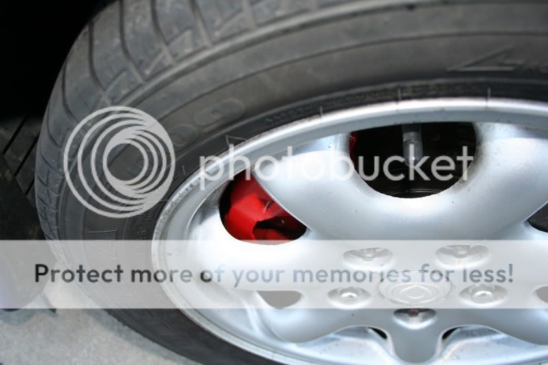

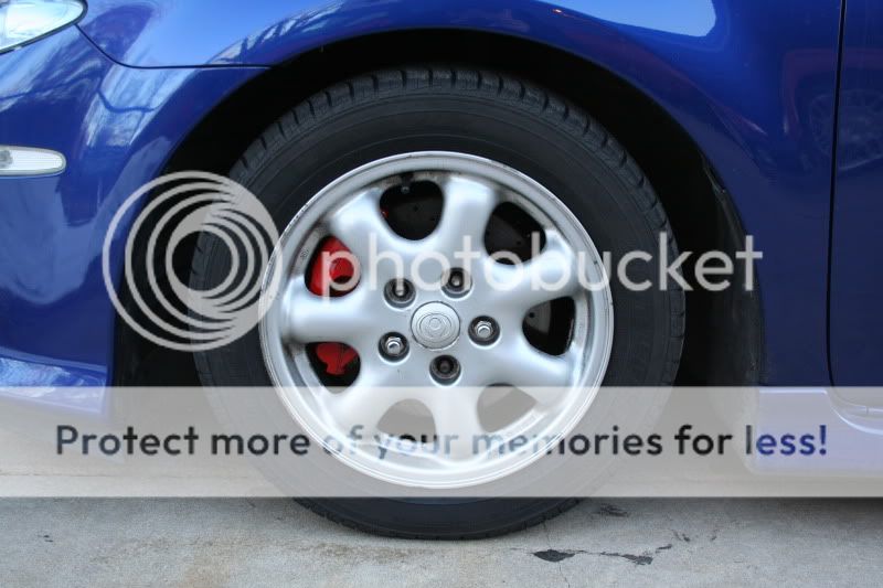

03-05 brakes mazda6 WILL clear a 15in wheel.
06-08 need a 16in wheel
mazdaspeed6 brakes need a 17in wheel.

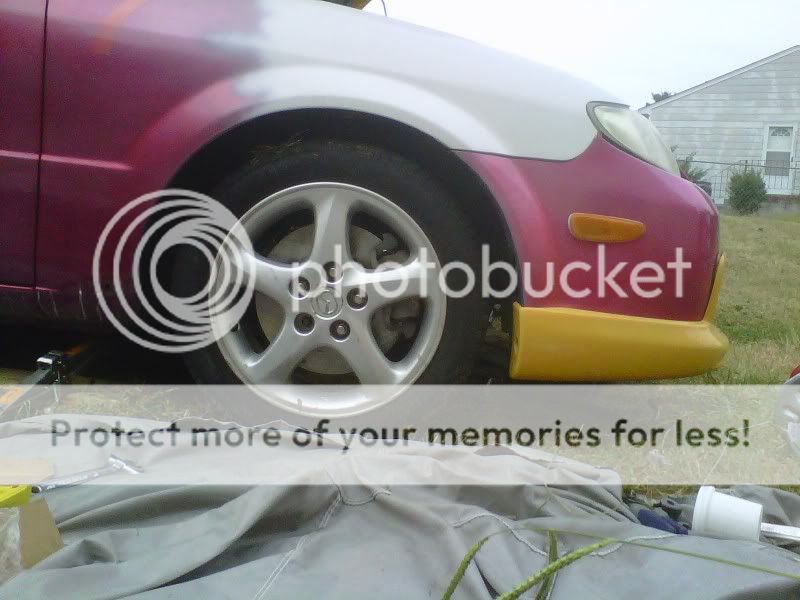

here's a pic of a OEM mazda 626 15in wheel on my mazda6 just to show that a 15 does indeed clear.
