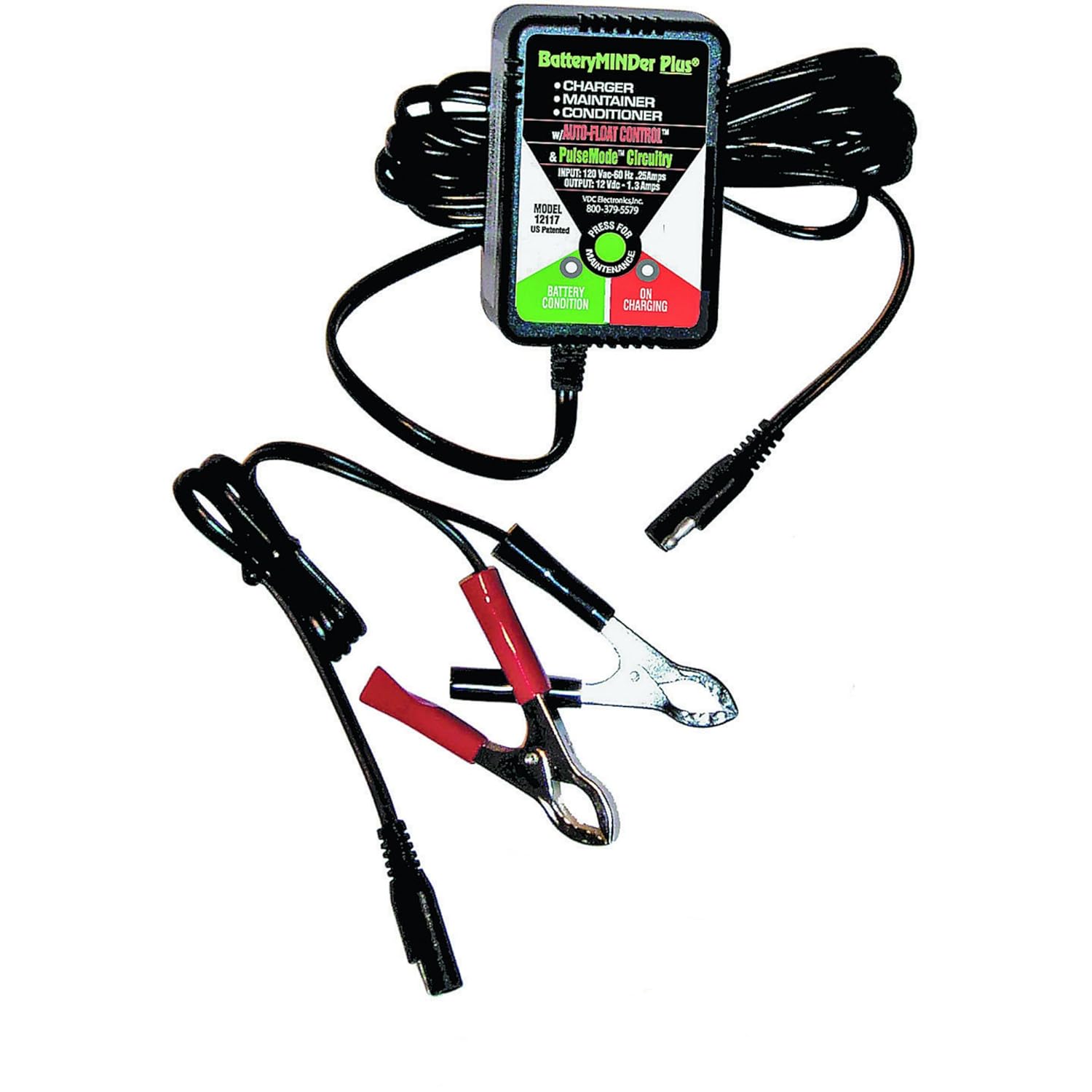

Does anyone in this forum recommend using the desulfation feature of a battery charger? I recently purchased a 15Amp battery charger which has that "conditioning" feature that's supposed to send pulses to the battery to reduce/eliminate sulfation. I'm also curious if you can just clip on the leads and condition the battery without removing it from the vehicle. I used the conditioning feature on my gas powered golf cart battery and it didn't seem to do any harm. My golf cart battery is 4 years old and going strong. My CX-5 sits for days at a time in the garage so I'm thinking the battery conditioning might be a good idea. Any feedback on those chargers and whether I can use it on my CX-5 battery while connected?
Every brand of automatic battery charger is a little different in terms of test cycles, charge cycles, etc. They are not government regulated in any way (other than the typical UL type listing). Some work better than others. Most are not temperature compensated so a charger that works super-duper at 65F will likely suck at 20F.
A well designed de-sulfation cycle is a good thing but it's not a miracle cure. Because some automatic chargers decide whether to go into de-sulfation mode based on feedback it gets from the battery, it's a good idea to disconnect the battery from the vehicle so as not to confuse it's automatic battery health diagnostics. A charger with a manual desulfation mode could probably be used with the battery installed but it might be slightly more effective without the slight extra load or capacitance of the cars electrical system.
A battery that is never deeply discharged and doesn't regularly sit unused for extended times is the best insurance against early death. It can also help to avoid things that raise the engine bay temperatures in warm weather. Little things like shutting the engine off for short stops, avoiding drive-UPS, etc. can reduce peak battery temperatures. I'm always amazed at people that leave their spouse in the idling car while they pick-up groceries! Not good for engines or batteries.
Almost all car batteries in the US are made by Exide and Johnson Controls. Prices vary between the brands due to the warranty.
I've used this model with desulfation mode on my powersports equipment for over 10 years. My oldest battery is around 9 years old and still works great. I am able trickle charge 4 batteries from one charger.
