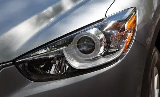

Has anybody thought about installing angel eye kit for their CX-5? I noticed that the low beam has a perfect circular silver bezel that would be awesome to mount a kit on!

Thanks! They look great, I sent an email to ask if they would know what size would fit CX-5s. If time and $$ allows here is what I was planning on doing for the headlights.
1) Angel Eyes
2) Tinting or removing the yellow turn signal reflectors (probably smoke them a little darker)
3) Switchback white to yellow LED signal lights ( I am wondering what these would like as DRL with the angel eyes and high beam drl all engaged)
4) HID kit, 4500K range, for low and fog
5) Xenon look alike halogen for high beam so that I can match the DRL as close to white as possible

#2 Have you considered making a clear acrylic copy and replacing it?
#4 If you follow my posts at all, you'll see I'm pretty vocal about the PnP HID kits. If you are going to have your headlights opened up anyway have you thought about replacing the lights with one of the mini's on TRS?
They are pretty easy. Remove the bulb, insert projector in from the front and lock the washers on the back. put in new HID bulb.

What are min's on TRS? I have actually thought about maybe buying the OEM HID light assembly at one point (whistle)
Whew... It took me a while to get caught up on all your post about PnP in halogens. I kinda wish you continued your plans with the retrofit on HIDPlanet to see how they came out haha (first) but I understand where you are coming from. I am also now starting to be reserved about putting PnP as a halogen substitute, but honestly I am even more reserved about retrofitting. Not sure if all the cutting and modifying can be justified with the cost and time required. I say this because for those who purchased vehicles without an option of an OEM HID headlights installed at factory have only retrofitting to "do it right". But CX-5 comes with HID as an option, granted a $2000+ option, and I am thinking the best route would be is to just purchase an OEM HID headlights and install it myself.
This of course would only be reasonable if the price is right and if it is possible to simply interchange the headlight assembly. So... does anybody know if you can simply switch from halogens to HID?

I think all you need for the factory headlights is a harness... I think you can order the one from Mazda otherwise you can make one or have one made. Bixenon headlits are $700+usd each. At that point, might as well do a retro. You can get a quad for less than that.

Did you ever get the Angel eyes? And if so, where did you get them? And how easy were they installed? I was looking at: http://www.theretrofitsource.com/product_info.php?cPath=31&products_id=14906
But I'm completely unsure how they would go on just because there aren't any area's on the Halogen headlamp for them to really be clipped to. So that only leads to them having to be mounted? Any thoughts? Thanks
