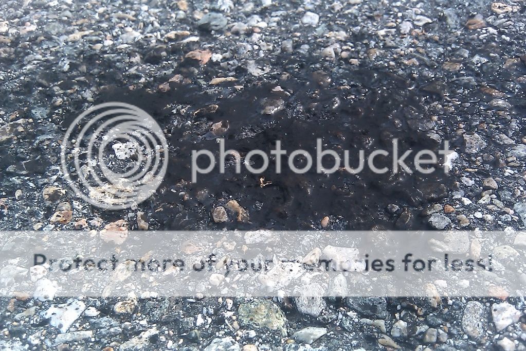

So, put everything back together, idles fine.
Once it warmed up, I gave it a few hard no-load revs, and...
That's from the tailpipe. A closer shot of the splotch in the foreground of that pic...
Yeah, it's oil. There has to be something quite seriously wrong inside the engine.
Holy crap dude. I was hoping to see that you had a positive update when I found this thread. :(
Well, doing some more research around the driving to and from work, and the general consensus is that the above pic can't be oil. Water or fuel that is tinted with carbon, but not oil. Any oil in the exhaust would get ignited by the heat and not make it out the end in liquid form. Which makes sense.
