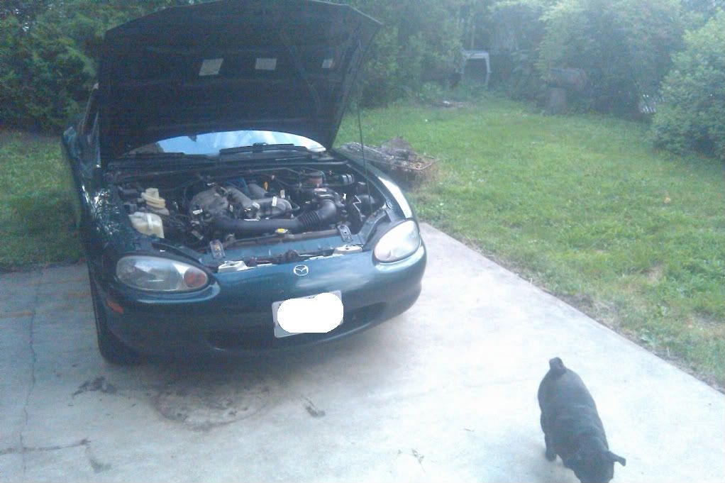

It's not going anywhere now. Took down a section of fence at the top of my driveway and drove it through the gap between two posts. Had 1.5 inches to spare. That's a combined number of clearance on both sides. :)
But plenty of room, flat patio, and a more secure working area than my driveway.

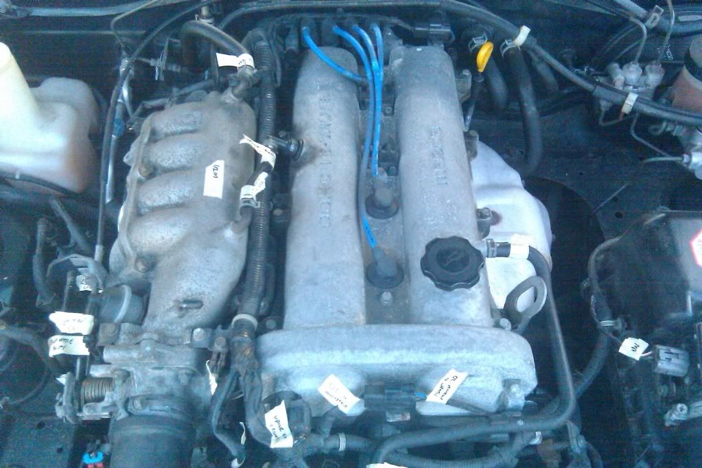

Some pics, before and during the work so far:

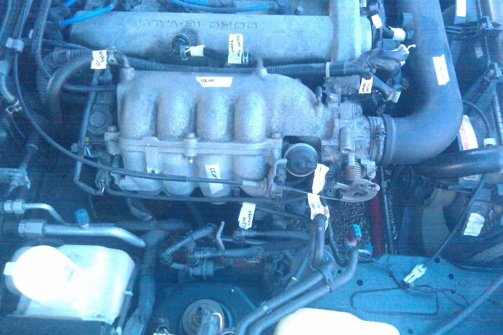

Tagged up as much as I could ahead of time. Tagging with tape as I go for labeling stuff.
Left side (intake)

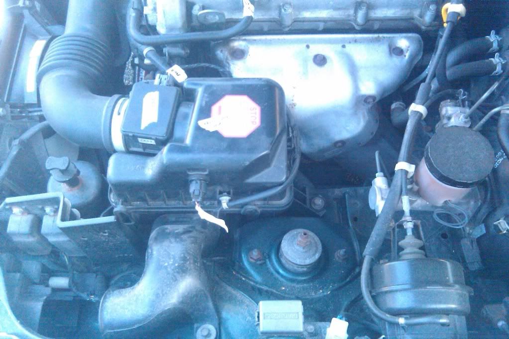

Right side (exhaust)

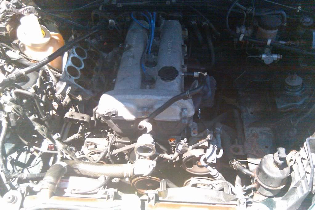

Center:

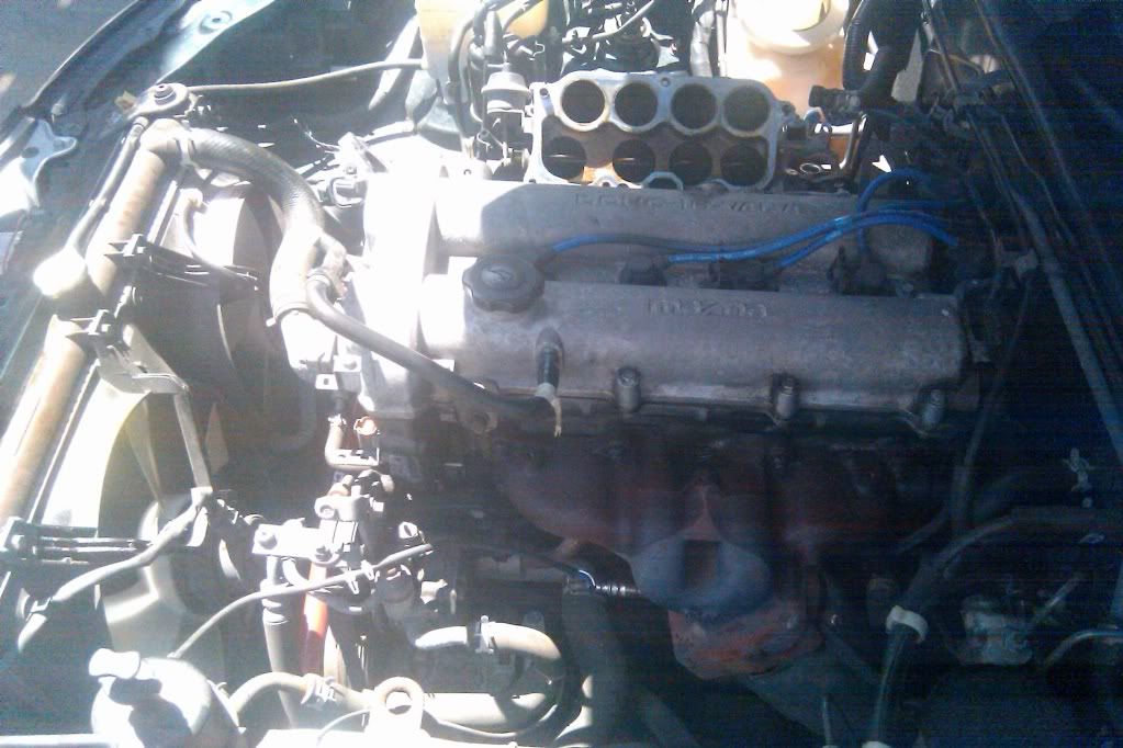

Right side partly disassembled: (PS and AC are both on this side's accessory belt)
Overall

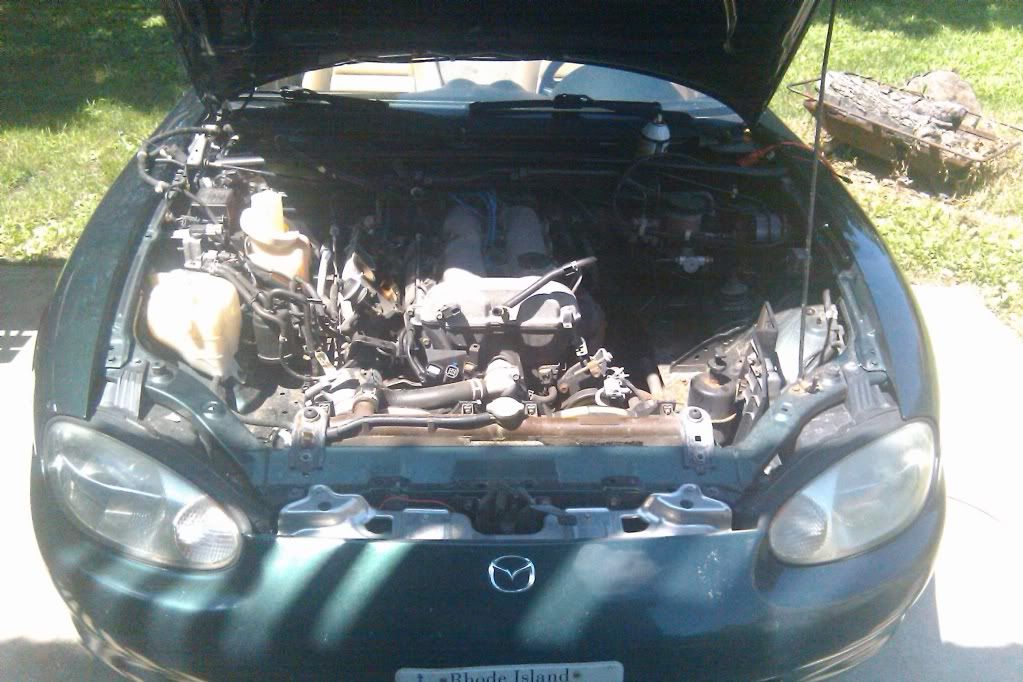

Closer
