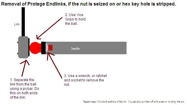

If your endlinks arent rusted then you may be able to remove them by inserting the hex key into the end of the endlink and using a wrench to turn the nut however, usually they are seized and/or rusted.
Best bet for removal at that point, is a torch/hack saw, or you can simply pry the part that connects to the strut and sway bar away from the vertical bar that connects them and then use vice grips on the ball side and then use a ratchet and i think 14mm socket to remove the nut.
Diagram I just made to try and explain what I am talking about.
