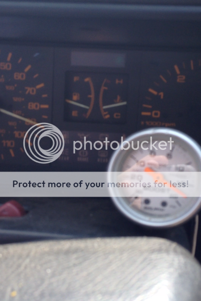

Fixed the boost leak now holds 17-19 psi to red line, instead of spiking 14 the going down to 8-10 feels like a whole new car
Gettin ready to hook up a wide band to make sure it can run it safely. It's only had 1 run so far

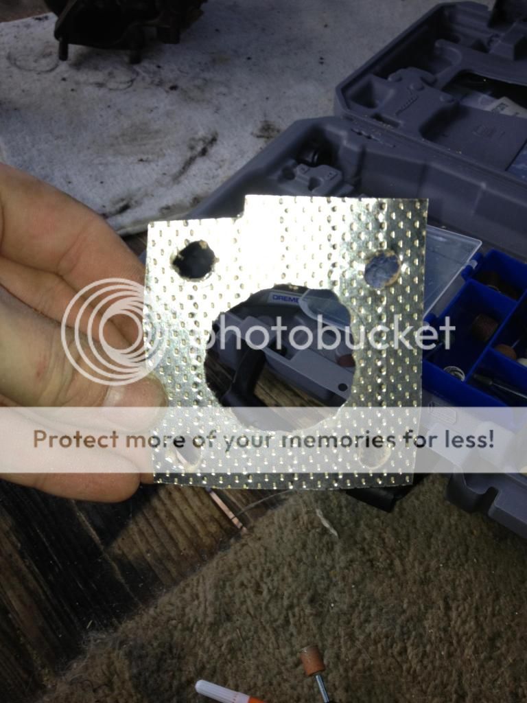

finally got a new manifold even though when i got it it also has a small crack but i would say the gasket was completely ******
couldnt get one the same or next day so i bought one of those metal sheets and made my own
it lasted a week
ordered an actual gasket
now it finally holds boost
