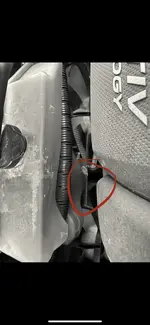

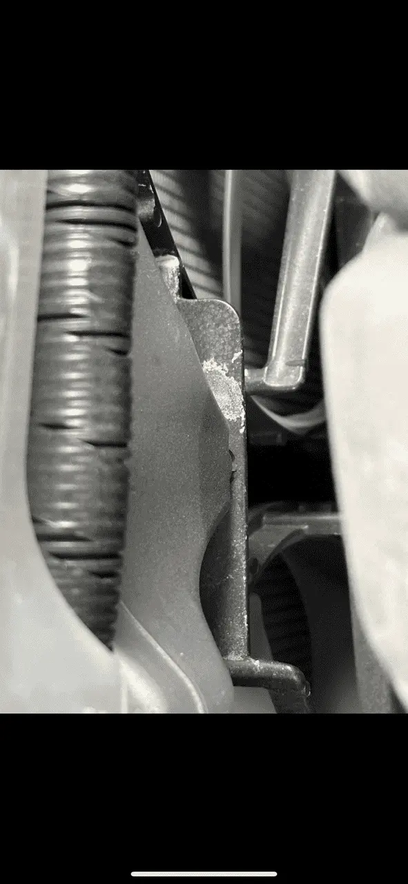

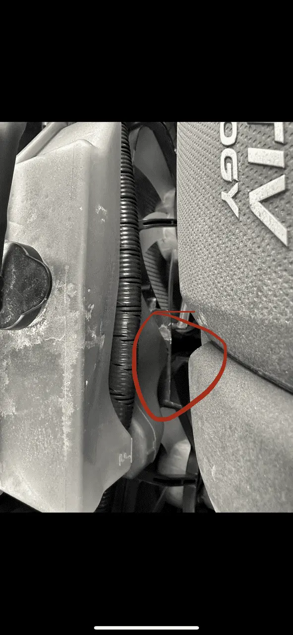

Does this look right to you? It’s a bit dark green? I do think this is how it came from the factory but I am not 100% sure. I am the first owner and leased it new and brought it.
Does this look right to you? It’s a bit dark green? I do think this is how it came from the factory but I am not 100% sure. I am the first owner and leased it new and brought it. View attachment 317684View attachment 317686
I can't make out the color in your pics, so I can't comment on that.
Is that the level of the coolant in the top pic with the red circle? If so, it's WAY too low.
Take the radiator cap off, with the engine cool/cold of course, and snap a pic of the color there.
If you're the first owner, then chances are, the color is ok. BUT, if the level was low from the factory, as mine was, and the dealership topped it off using an incompatible coolant, it could have messed with the color and the mixture.
Look again at the first post in this thread. That's the color the coolant should be.
I can't make out the color in your pics, so I can't' comment on that.
I agree it is hard to tell the color from the pictures. He said he leased the vehicle new and then bought it. A gray color would indicate possible contamination. It could be from a top up with the wrong coolant or something as serious as a bad head gasket. I'd have the vehicle checked out by a trusted mechanic.
