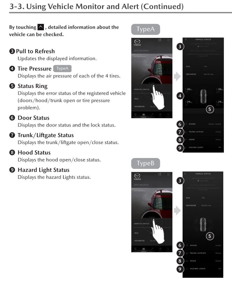

I bought a '21 GT-R on Wed, and was also surprised that you can't see tire pressures. Are you using the MyMazda app? Even more surprising/frustrating, you'll find that there are two possible vehicle status screens. The "A" screen is for 2020 models, and it does show tire pressures. The "B" screen is for 2021s, and there are no pressures.

The two vehicle status options are shown in the Connected Services manual that you can download as a pdf. On Page 4, it shows one screen for 2020, and the other for 2021.

I want to correct what I said about the two screens. Page 4 indicates Type A is for 2020, and Type B is for 2021. The tire pressures are shown for Type A and not for Type B on Page 47 of the manual.
