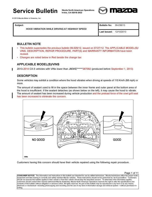

NEW UPDATE TSB FOR HOOD VIBRATION! Any CX-5 produced before Sep 1, 2013.
TSB Dated 12/10/2013
It's an 11 page TSB, I access on Alldata, they're photos, instead of PDFs, I'm only posting 1st page.
Great, thanks! Will use this for discussing my noisy hood with dealer.

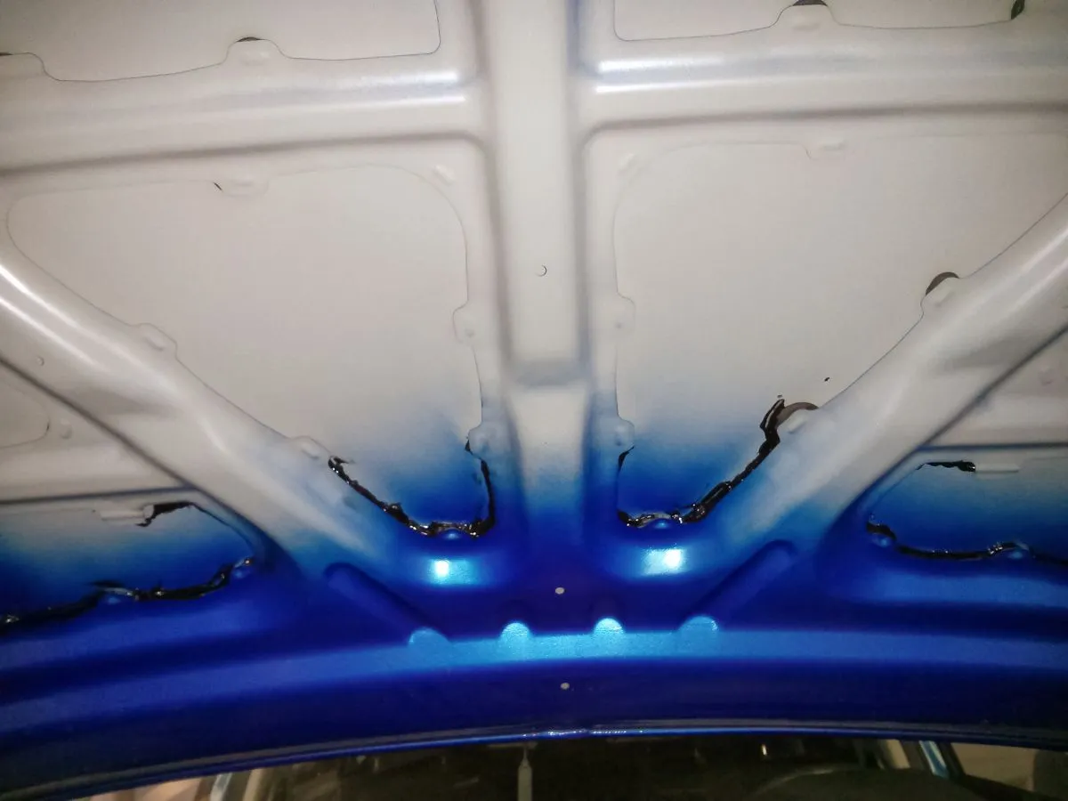

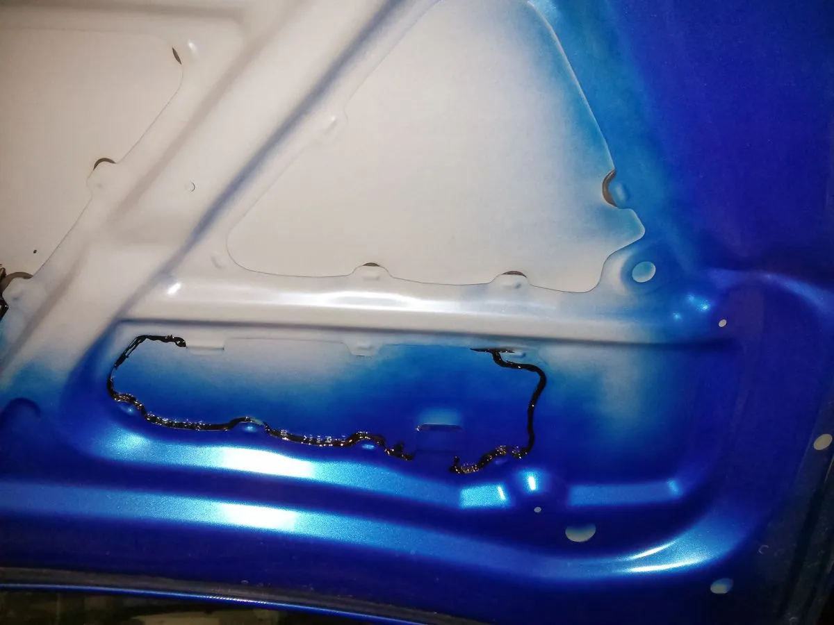

Removed insulation panel
My dealer fixed the hood few weeks ago. The fix seems to have reduced the vibrations somewhat but have not eliminated them. The hood will tremble especially when driving over highway patches, the kind you would not slow down for, and sometimes bridge seams, warning strips etc.

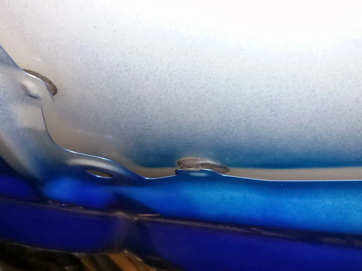

Given that the issue was not 100% resolved, I was too curious and today I removed the insulation panel to inspect the work. Here are some photos.
The black material is some type of glue / caulk . It is pretty stiff and holds the parts together pretty good. However, they applied it only on the part closest to the windshield. Most other older glue points were ok. These are of blueish color. There were very few which were missing and I found only one which was broken. This can be seen in one of the images. That section does move somewhat if I apply pressure. Compare to the section with the black glue where there is no movement.
I am not sure of applying glue all around everywhere is the right thing to do. I'll raise it with my dealer on my next regular service.
BTW, I removed the push-in pins carefully with a tool https://www.amazon.com/dp/ (commissions earned). They are pretty short. I was able to reuse them all with no issue. Be careful not to drop any to the engine bay.
I read the TSB. It only said to the put the caulk/glue/whatever in the area you took a photo of.
