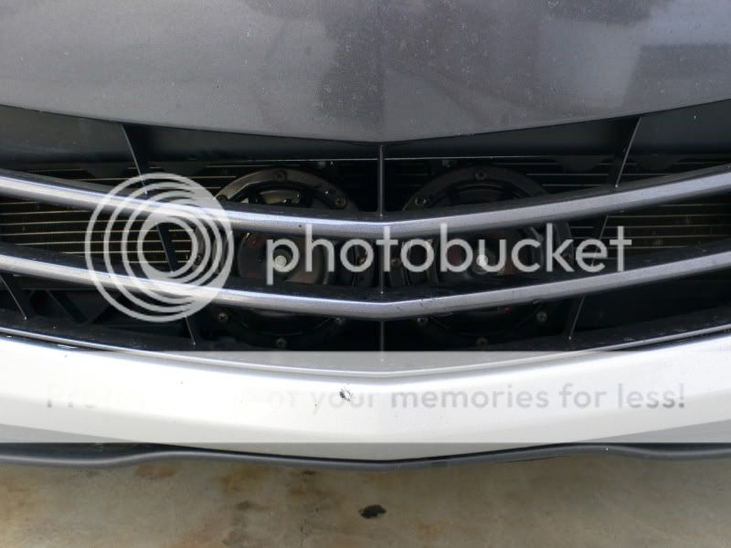

i havent posted in forever, but here is a pic of my horns painted black behind the "smiley". sorry its so dirty
Looks good! Sounds like a lot of work just to upgrade the horn, I'll just deal with the weak horn.
