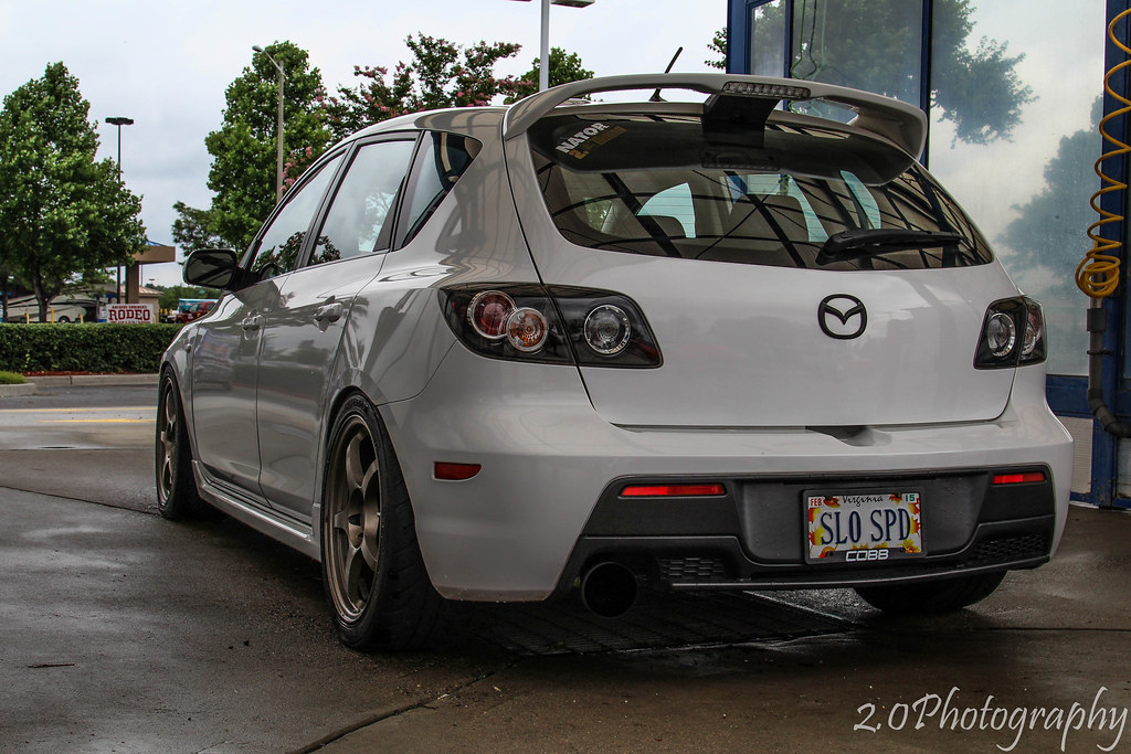

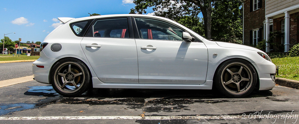

Hi guys i just want to make this thread to show my progress with my newly acquired gen juan CWP MS3. The car has 110k on the chassis and 4k on the pu motor (feb 2013)
Current Mods
Engine:
PG Turbo Kit with Borgwarner S360
HTP 4" Intake
HTP 51R Battery Tray
CFM Oil Cap Breather
SSP Primary EGR Delete
SSP Secondary EGR Delete
Corksport Oil Catch Can
Fumoto Oil drain Valve
SURE 1/8" IM Tig
SURE 1/8" TB Tig
NGK 1 Step Colder Plugs (.25 Gap)
HKS CBE
PG Under Motor Piping kit w/ Treadstone TR8
GFB Respons 50/50 BOV
Tokay V1 Injector Seals (Waiting to Install)
KMD Fuel Pump Internals
4-Port EBCS
Cobb V3 Accessport (Self tune)
SP63 Ported Intake Mani
3 Bar Map Sensor w/ SP63 pigtail
Aquamist HFS-3 Meth Kit (Dual 1.2mm Nozzles)
Howerton Engineering Dual 2 Gallon Tank/Pump enclosure
Drivetrain:
Act clutch
Act Flywheel
CP-E Stage II Rear Motor Mount
Corksport Passenger Side Mount
Corksport Transmission Mount Insert
Interior:
Ralco Short Throw Shifter
Corksport Shifter Base Bushings
Exterior:
DDM Tuning 5k low beams
DDM Tuning 5k Fog Lights
Cp-e Towplate
Ray's Engineering Gramlight's 57F 18x8.5 +37 in front +40 in the rear
8mm Spacers in front
5mm Spacers in rear
Ray's Engineering Black Lug Nuts
Dunlop Direzza ZII's 245/40 R18
Suspension:
Fortune Auto Coilovers
Moog shorter front endlinks
Dominant Engineering Rear Camber Arms
Corksport Rear Sway Bar
GT Spec Rear Tie Bar
EBC Yellow Pads
Centric High Carbon Rotors
Goodridge Speed Bleeders
Goodridge Stainless Steel Braided Brake lines

lol i did that before i went across the street to the weekly mazda meet. I wanted some solo shots haha. Here are some from the meet, and yes we now have our weekly meets at Hall Mazda. There were way more local guys there then what you see in those 2 shots.
this thread is need of some love. i updated the op to show some new mods and some new pictures from yesterday. Suspension still needs to be adjusted more and i have a appointment setup on Thursday to get the car aligned.
Its people like preferio or whatever his username is, that makes people not join or leave forums. Theres nothing wrong with posting updates on things you have done. Even if people didn't post, they are still viewing the thread. I mean thats what I do, I've been on this site on and off for 4 or 5 months before I made an account yesterday. I don't understand the hate people have for one another when we all enjoy and have the same passion for this certian car make. Car looks good 2.0 except for the gas cap cover lol no offense.
lol chris (perferio) wasn't being serious. Thats my boy hahaa he loves to bust my chops and same for me i bust his balls all the time. Gas door is stock if i ever get a good deal on a paint matched one i'll swap it out, but it's really low on my priority list.
just plastidip it and watch all the spilled gas melt it every time you refill
