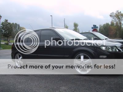

Thanks man. They are Enkei RPO3's in the SBC finish. They look alot better in person.
Here is a couple more.... HP Evo 18x8 with 225/40/18
