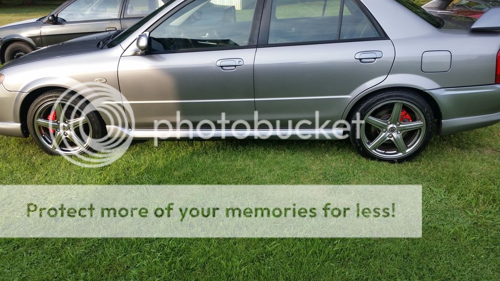

Got it all washed and put the cover back on the engine. I think its pretty damn clean
Then today I finally got to painting the other 3 calipers and cleaning up my shocks/struts. I like it a lot. I think it gives it a little kiss of color (that it needs)
Now I just need to get tinted...
Just now seeing this - it looks AWESOME. You've done a great job with it! You should be very proud, especially looking at how the car started out, and how much you've learned.
Thanks man.. Since my last post, I've done a 3" DP, and tapped the turbo for the wastegate signal..
I have DaveB rings, rear end links, lower control arms, and an Exedy clutch that still needs to be installed. Then I need to work on fabricating the rest of my exhaust..
But its coming along.
