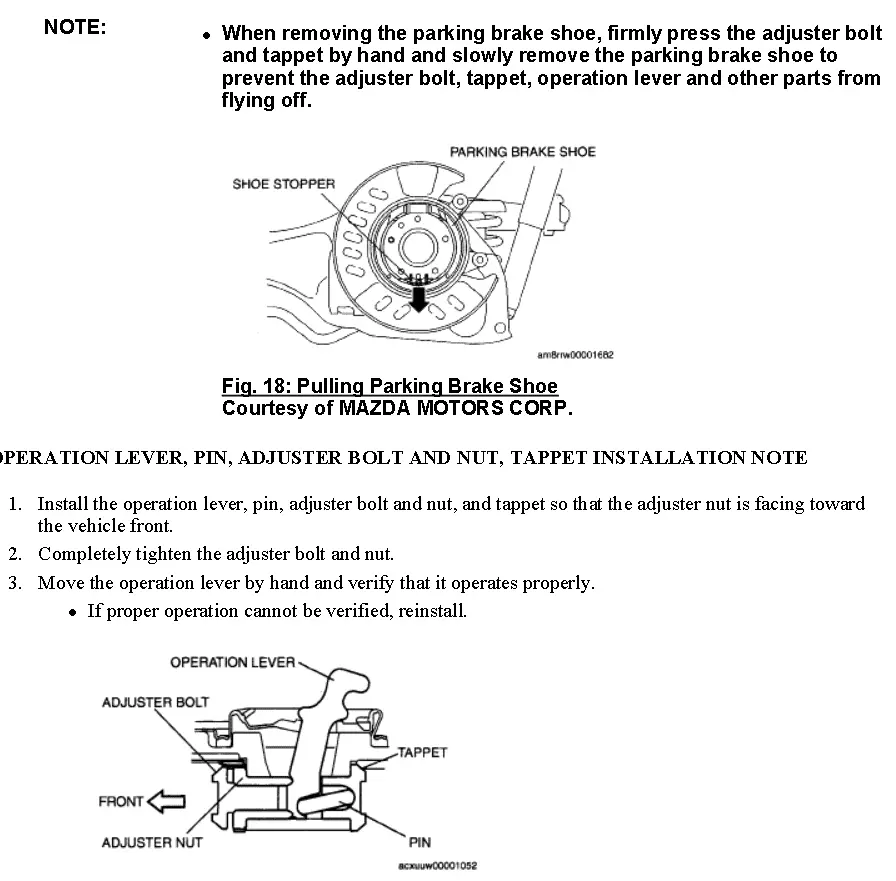

Try adjusting it at the park brake or at the rotor. Being a drum brake, they need regularly adjusting.
Thanks for the suggestion. Do you have any insight on how to do that?
It's a real b---- to adjust. My adjustment knob was so rusted that it wouldn't move. Took hours of heating it with a blow torch and tons of PB blaster to finally get it to turn. It's back to needing an adjustment again but I'm so reluctant to do it again...
