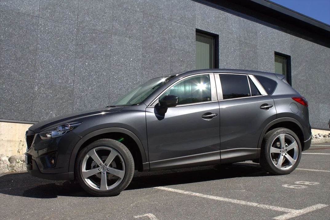

Been so bored waiting for delivery of my CX5 so have bought these on 20x9j rims with 245/45/20 wheels
Wow only taken four months
