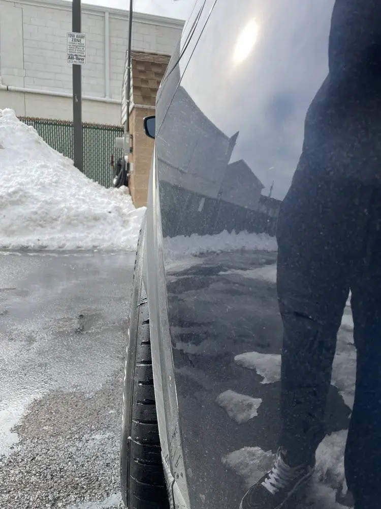

18x9.5 +35… if the tires weren’t so fat, the rim of the wheel would be flush with the fender.
