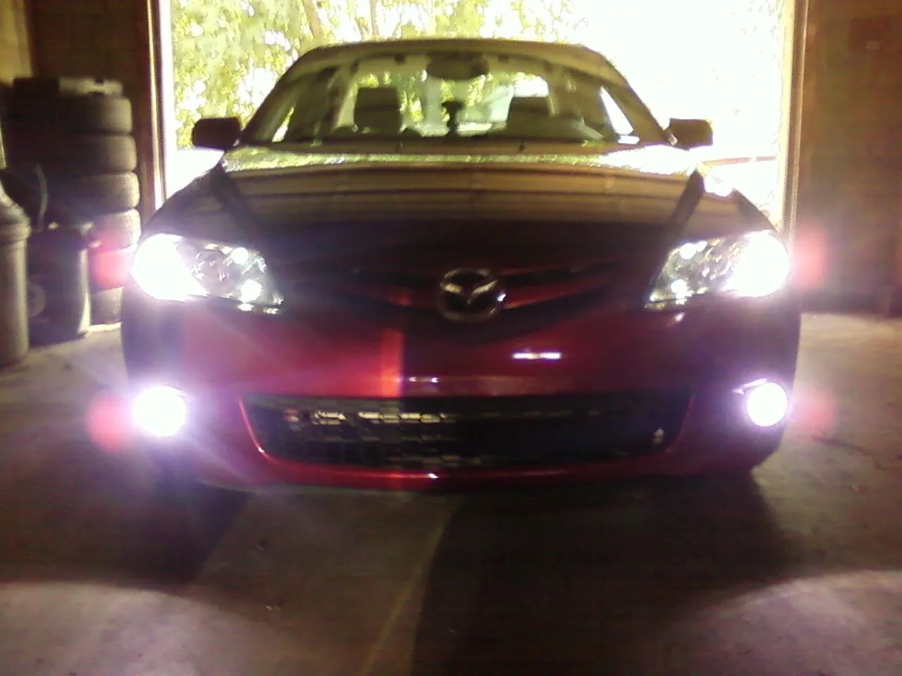

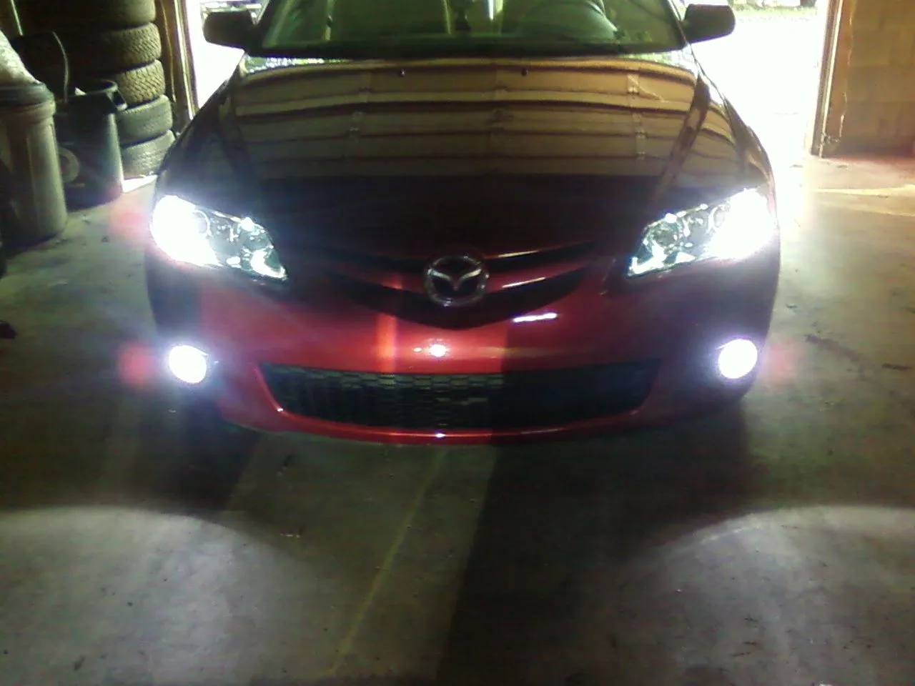

TunerSteve enjoy the setup. Here are some crappy pics from my cell. I'll get some better one's shortly.

Just got done, really looks good. One big problem, the fog light bulbs are too shallow to get in correctly. I had to actually get the reflectors out of the fog lights because they wouldn't fit. I will most likely buy a new set of fog lights to fix this down the road. Everything matches, and I found a solid spot to mount them, but put things back together to get it driveable tonight. Pics will be coming soon.

Ran with them last night, much better peripheral vision at night, and not blinding to anyone. I was out last night so I didn't get a chance to take a picture. I have one on my phone that I'll upload later so you can see the view.
