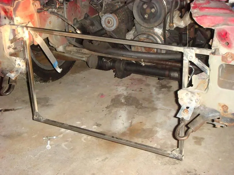

Not done, but here's what I did yesterday. :) Plenty of room now. Although not pictured, i made some braces to support the corners. If I press my foot down, there is no deflection :) Going to get a aluminum crossflow radiator (24"x16" overall 2 1" core) to mount behind the support, and the intercooler fits perfectly up front. Still need to make the brackets for it.
Now to do something about that rust..

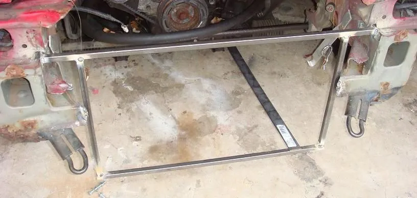

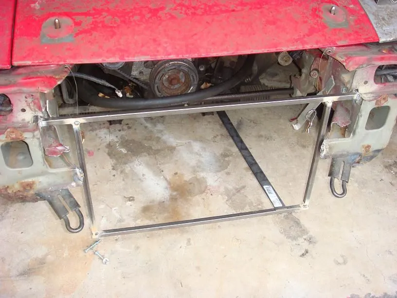

Ok. got another pic taken of the new core support. Once the raditor gets here, I'll make tabs on the bottom to hold it, but need the final measurement.
-ugh- the flash is not kind at all, it shows all the dirt and rust.

Fadi,
Are you going to add any additional support to tie the two frame rails together? I foresee a significant amount of torsional twisting in the front end with that much metal removed at the front.
Fadi,
yes i will. But honestly I don't see that much force that far up. It's well ahead of any suspension component. But i'm planning to add a bar up from to act as a bumper/support.
