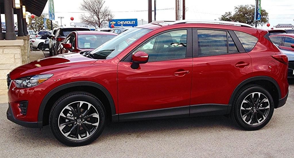

I really wish you could see it better, but I love the OEM wheels on the new 2016 model. I like how it matches well with the new grill.
So it appears that the new 19s are the same as the old, but with a different paint treatment?
agreed, love the lights though. has anyone colormatched the mouldings yet? have seen it on white and matte black but it makes the car a bit bloated in those colors.
all of the color "matched" moldings I've come across are off color enough to be noticed. Same with many of the fender flares.
Mazdasweed's matte black is the closest I've seen. Still waiting for someone to do this to a Black Mica.
The '16 rims look too busy IMHO

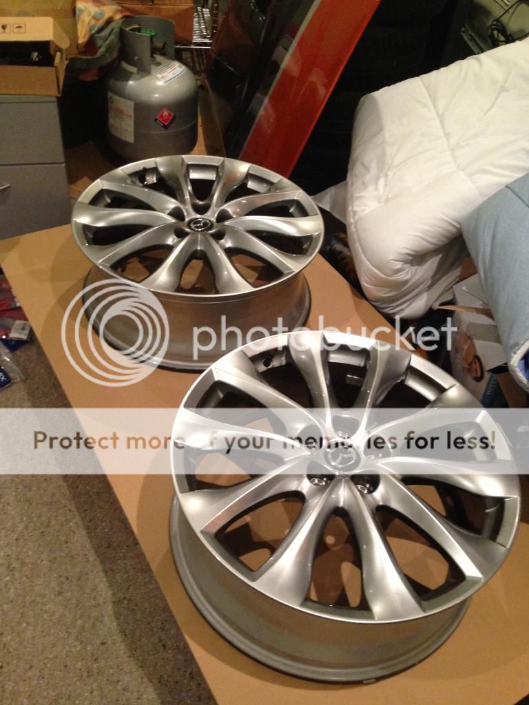

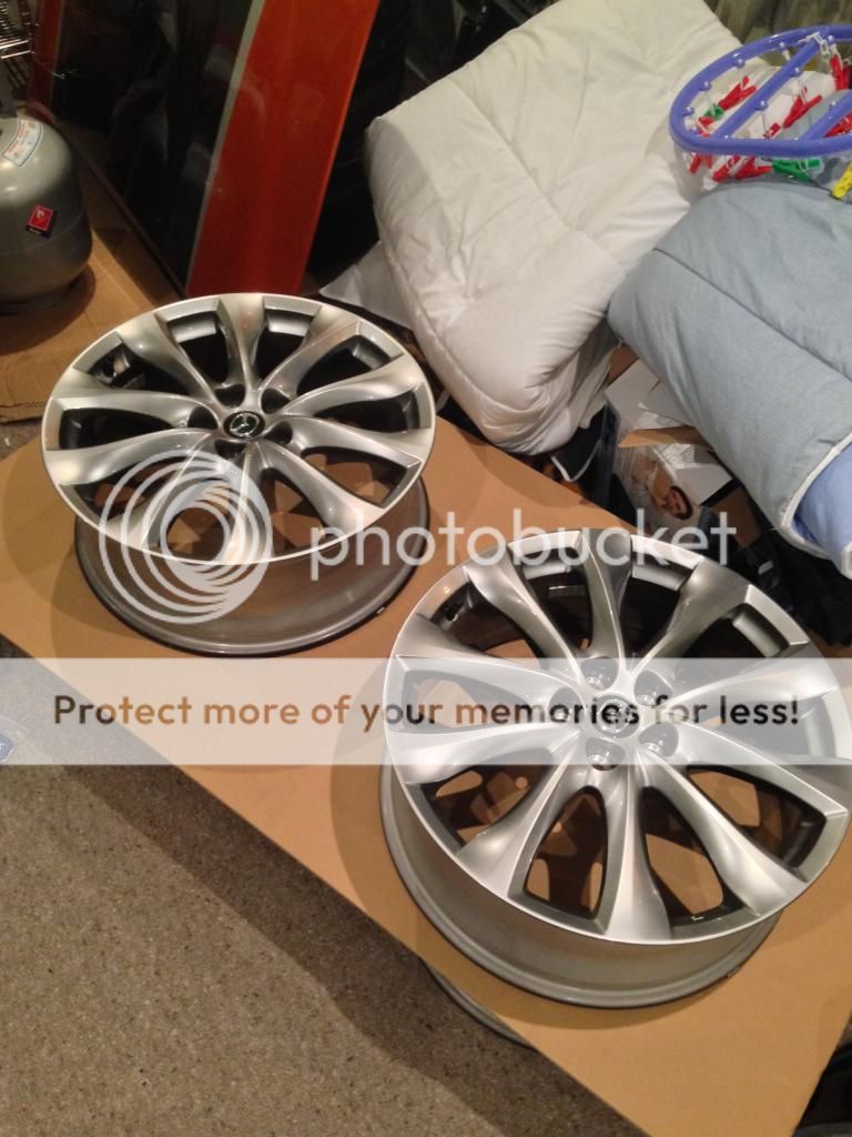

New wheels arrived, just need to fit tyres and put on car , will go and take pic as they are in my shed
Great having a Mazda Dealership guy as a mate , when clients buy new cars and upgrade the wheels to 22" he helps them offset the cost of te upgrade by finding a buyer for them , luckily I got in first before the mag wheel shop that snaps them up, sadly the oem 20" rubber not the right size for my CX-5.
