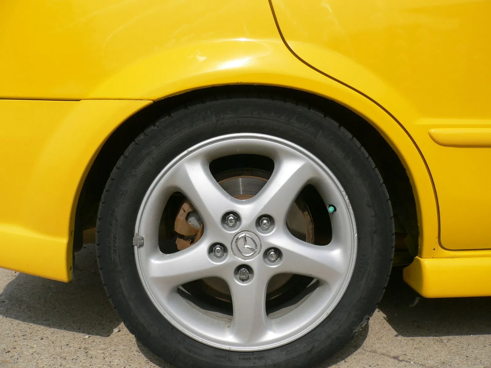

this is what a 205/50/16 looks like. doesnt handle nearly as well as my 215/40/17's
taller sidewall too, but my 17's are all bent to hell (pissed) so i have to use my winter tires til i get new summer rims
