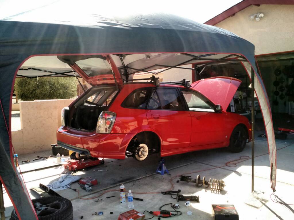

After a full day and nights work, yellowspeed coilovers finally on!

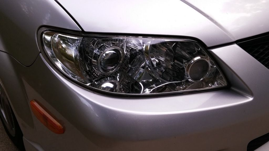

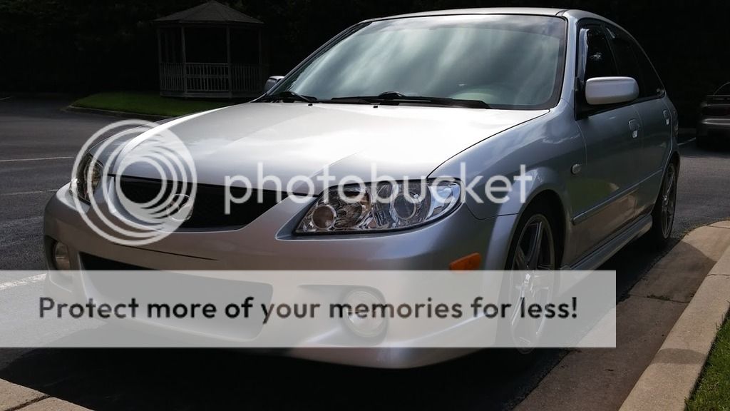

Retrofitted some restored headlights with H1 minis:

Hank3, those look great. What shrouds are those, and how was the install?
Thanks. They're the Mini-Gatling Gun shrouds. Overall the install was pretty easy and straightforward. It's just a somewhat time-consuming process with the bumper and headlight removal, baking headlights, installing and tuning the projector, and then aiming. Light output is noticeably better in terms of coverage and brightness but my cutoff is bowed...due to not tuning the projectors fully. High beams with the bi-xenon feature are very nice as well. I have them wired to work with the stock halogen high beams. Overall they're really bright on back roads!

Thanks. They're the Mini-Gatling Gun shrouds. Overall the install was pretty easy and straightforward. It's just a somewhat time-consuming process with the bumper and headlight removal, baking headlights, installing the projector, and aiming. I bought some other things as well for it, but the necessary things for me were:
OEM restored headlights - $85
H1 Mini Projectors (B-stock/generic) - $43
H1 5000K bulbs - $11
I already had HID ballasts and a relay harness. Light output is noticeably better in terms of coverage and brightness. High beams with the bi-xenon are very nice as well.
Great job, they look fabulous, now sell them to me (yes)
It made me consider the $200 setup on the TRS site for already having ballasts and relay harness but I need to finish the projects on the car/truck that have already been purchased and sittin waitin on me to have free time to get to.
