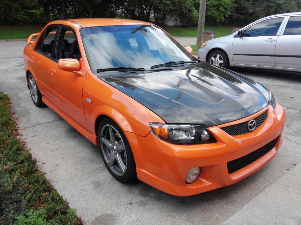

Painted the wheels yesterday.
Stripped them Saturday.
Sprayed them with three coats.
Not perfect, but much better than they were.
