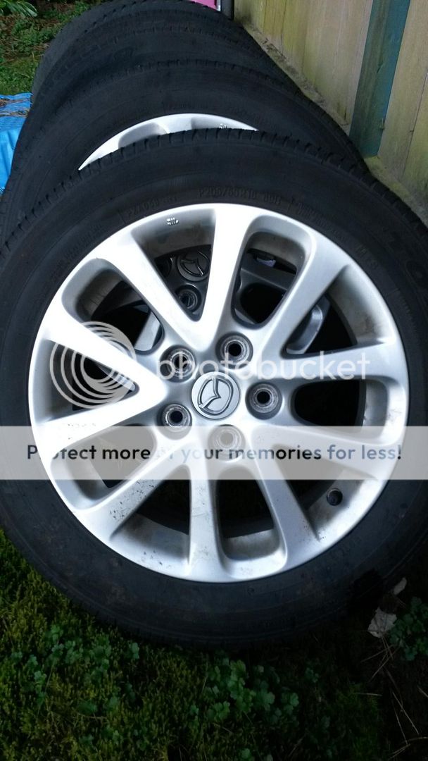

also picked up some mazda wheels for the p5 but have no idea what they are. they kinda look like mazda 3 wheels and have mazda stamps on the inside but they dont really look like any mazda wheels i found on google. almost like vw wheels.
prob gonna paint them. just not sure if it will be black or bronze for the p5. bronze prob a little bad for yellow msp though.
That is strange, I thought I had seen every mazda wheel but I don't recognize those. Must've been a Canada-only wheel or something.

I couldn't find them on google. Closest thing was vw jetta wheels but these have mazda stamps heh. They look a helluva lot better than mazda 3 16s though so happy. Don't really suit the msp but should look great on the p5 in a dark color. Msp gonna get enkei rsf5 but prob next year.

2008-2010 mazda 5 oem rims. though after sticking them on the black p5, i almost dont want to paint them.. i was thinking black or bronze, or gunmetal, something neutral.. but.. they just look good in silver.
