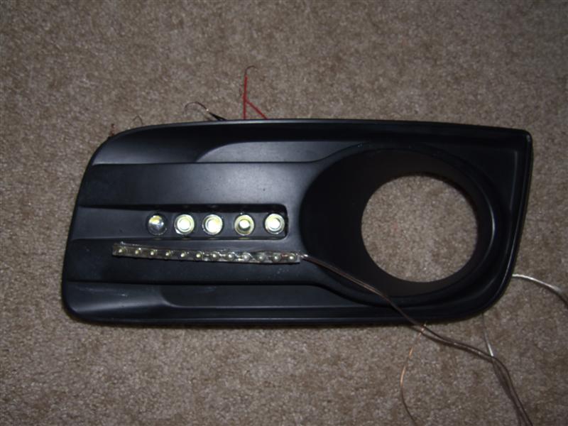

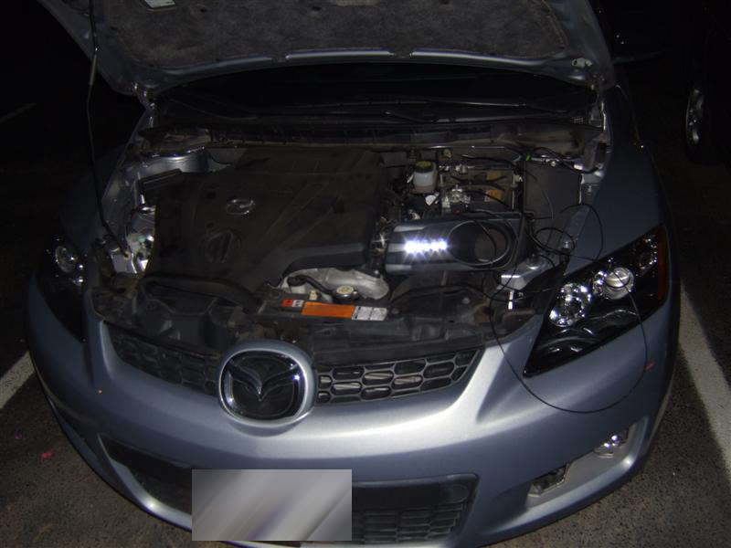

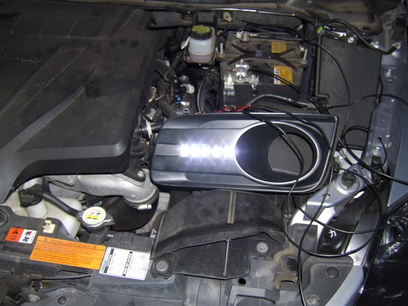

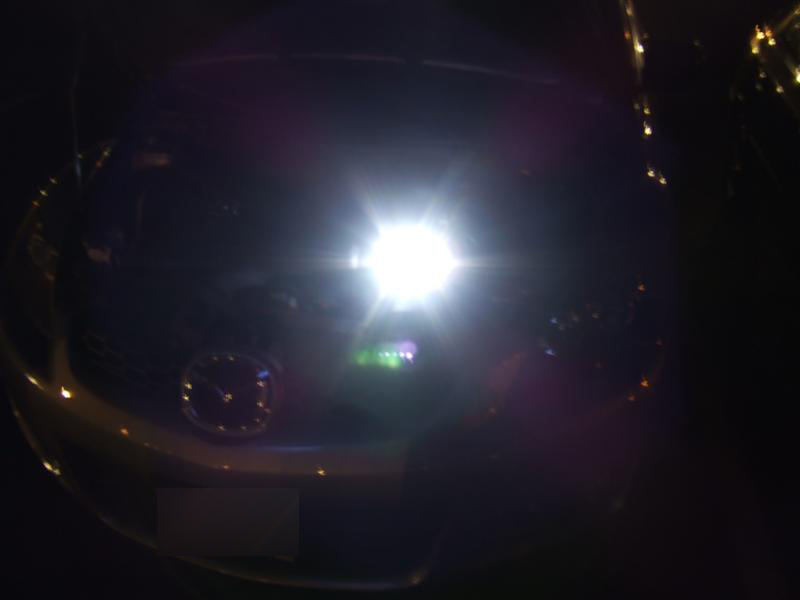

Well my lights finally came in took the old oznium leds out and now putting these bad boys in, This is not completed yet as I got home late tonight but here you can see for yourself how it looks so far.
Due to the way most cameras dont capture the full light output trust me on this one, these things are bright. I just have to correct the corner light so they are all focused at 45 degrees output but heck they are exactly like the audi s8 drl lights. For more info see the DIY guide I posted in the how to section *if ordering the lights they now offer them prewired as you can see I am trimming the wire so the end result is neat I was just taking these pictures to show you.
NEW lights compared to the old OZnium LED

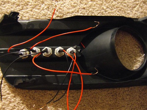

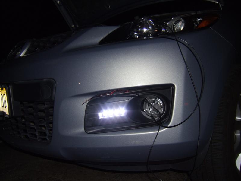

you will also need a 1/2" drill bit to make the holes on the fog light platic cover housing then is just a matter of running cable the lights are prewired and also have built in resistor all you have to do is wire them to battery and a push style rocker switch and also if you want turn signal relays

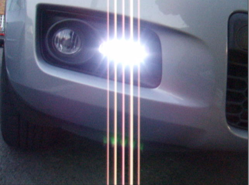

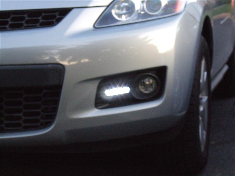

Heres the finished end result

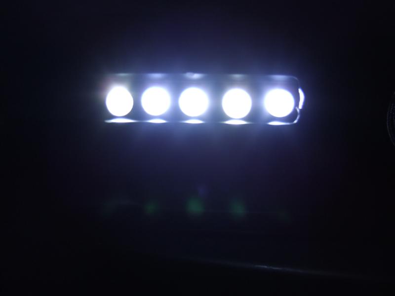

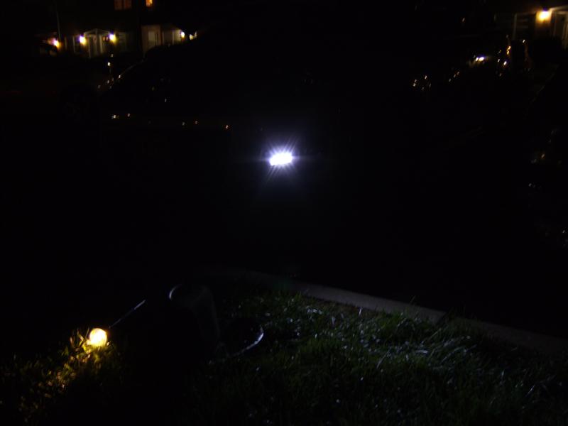

This picture is closer to how bright the lights are
they are directional facing foward but not into oncoming drivers eyes

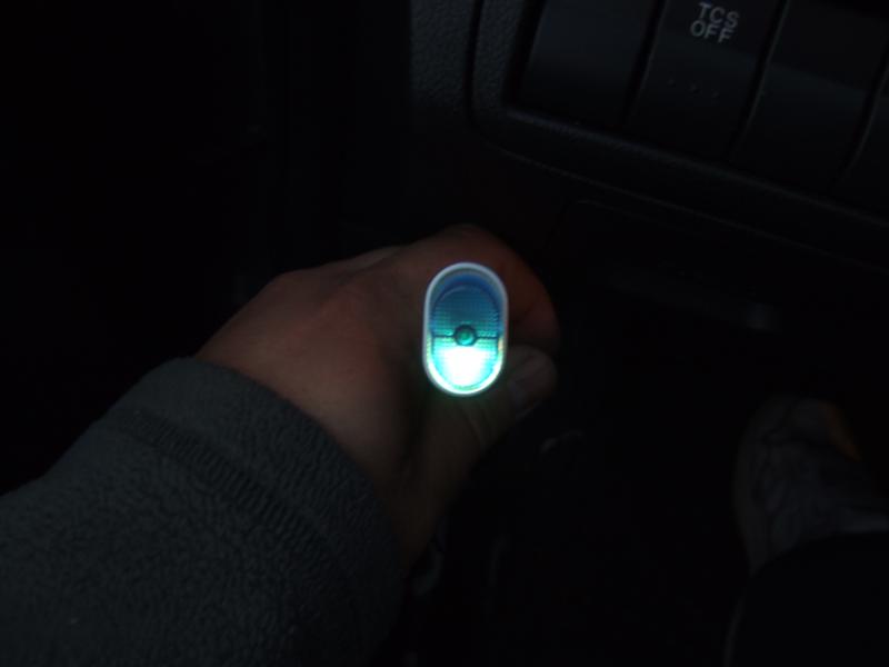

The Lighted jelly bean style rocker switch not sure where I want to place it yet or purchase a better rocker switch
why do you need a stupid switch like that? what you done is cool but the switch is just totally out of place.... wire the s*** up to the parking lights and get rid of the parking lights doubled onto the turn signals... make the turn signals just turn signals which is the way the JDM and euro cx7s work!

They are going to be wired to turn signal but only using relays. The reason I have the so called "Jelly Bean stupid switch is because" well not sure to be honest but the car is leased so at the end of the lease its going back to normal which is no biggy I bought enough lights to last me a while. and the Black oem housing I can get a set cheap from a local dealership. I did put the switch as a way to turn them off in the event one of the men in blue decides to harass me about having bright leds on at night hey you never know. the switch is going to be left on and tucked away behind the fuse compartment so nobody will know about it but me and well you guys now. But it is going to be wired to turn signal and on ignition start.

***if anyone is attempting to do this please dont rush the project think before anything at least twice. and remember our cars have curviture front bumper so you need to drill the holes in an angle so the lights face forward and not to the sides very important step here. Also doesnt hurt to use crafts glue to seal in the lights at the back from any moisture simple glue gun does the job.***

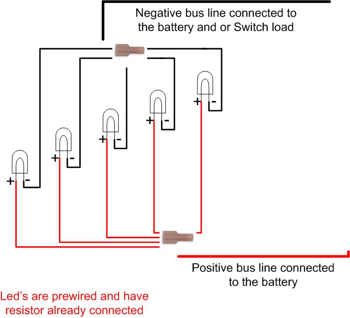

Look at this picture see they are prewired and the resistor for each light is already attached at the base of the led light. now what I did was joined all the positives to one side and joined the negative to opposite then use a quick disconnect male ends and crimp them. Then I ran two main lines 16gauge cables with female quick disconnect ends crimped. In my current case one positive to the car battery and the negative line from the switch load line. Then at the switch connect the negative line from battery so when you hit the switch the lights come on and off.
