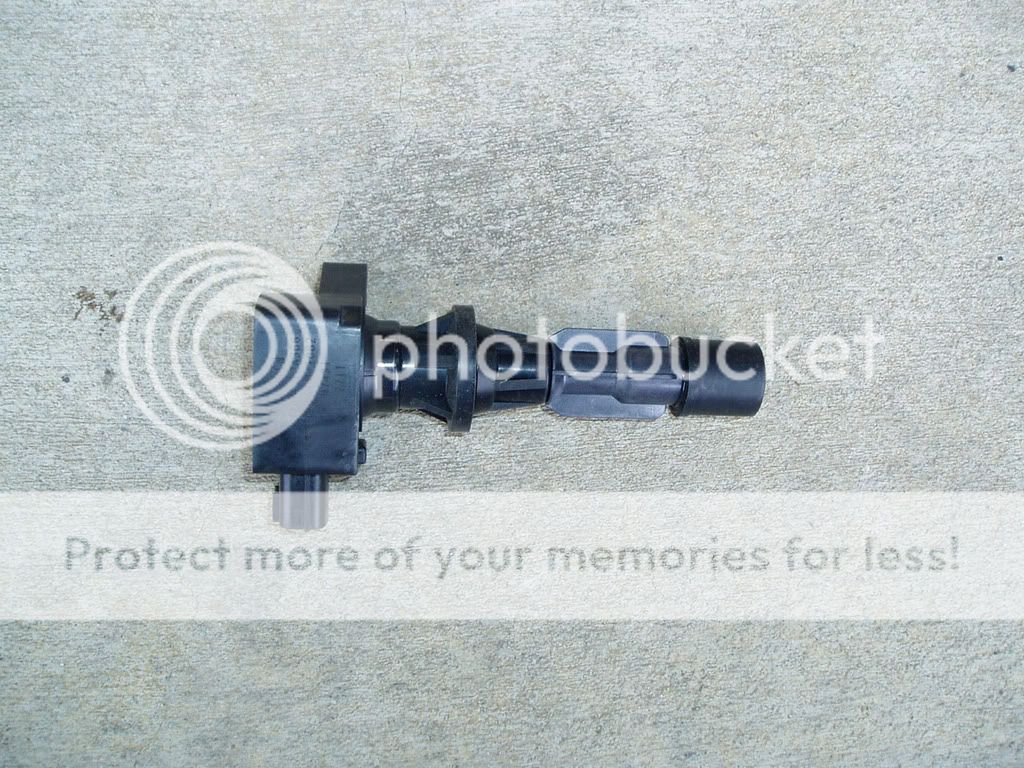

as for the coil stretch mod:
credits to cld12pk2go
Remove ignition coil:

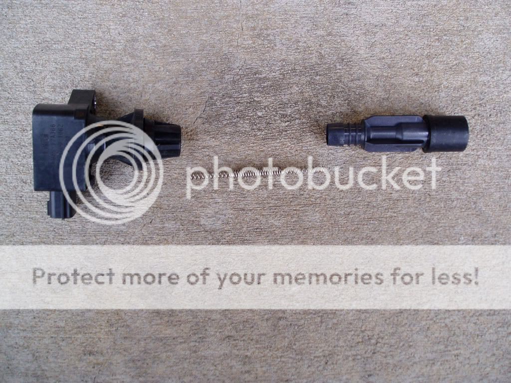

Pull apart to reveal the coil spring:

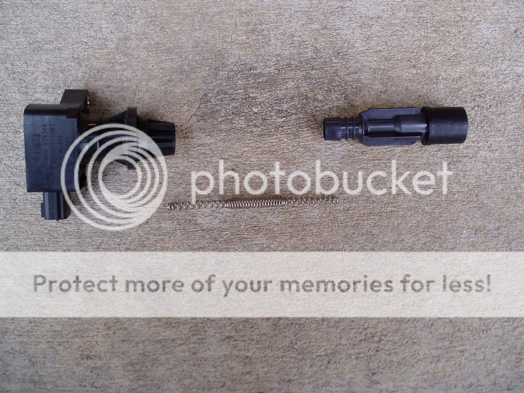

Stretch the two smaller sections of coils by ~1/4-1/2'' each.
Put back together. You will now have more contact force on both ends, which some people have found to help.
It is really that easy.
As far as performance gains...?
Some of the guys were experiencing misfires under hard acceleration. The theory (which the results of this mod seem to be bearing out as true in some cases) is that it was due to spark plug misfires caused by poor contact at the spring ends. Taking the spring out and giving it a little stretch appears to correct the problem for some people. It is free and unless you are a complete idiot who shouldn't be allowed to play with tools almost impossible to screw anything up, so it is worth a try if you have misfiring.
To tell the truth, I wonder if the results are due to taking it apart and putting it back together, which effectively creates new contact points, and the stretch actually isn't even needed. Kind of like when your home stereo's sound starts to degrade for no apparent reason and all you do is twist all the rca connections back and forth a couple times and the sound cleans up because you cleaned the contact area.
