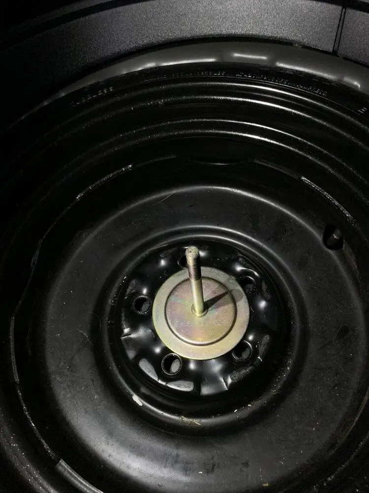

zer0sum Jun 21, 2021 #1 I cannot figure out how to get the spare tire out/unbolted. It’s almost as if it’s upside down (according to the manual it depicts using the lug nut wrench. Am I crazy or?
P pcb The Diagram Dude : 2002 MP5 Jun 21, 2021 #2 I'd try a pliers or vice grip on the stud to unthread it. My car has a big bolt, maybe your car had the factory subwoofer mounted on top of the spare tire, so it's different?
zer0sum Jun 21, 2021 #3 Ahhhh! That makes sense then. Before I owned it the car did have the subwoofer in the back. Thank you for the info.
