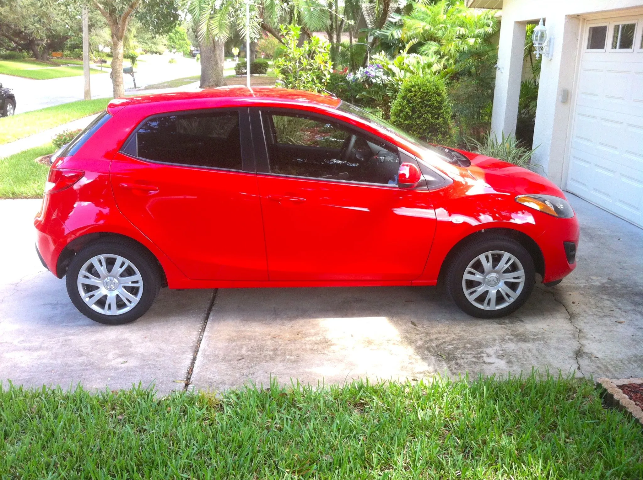

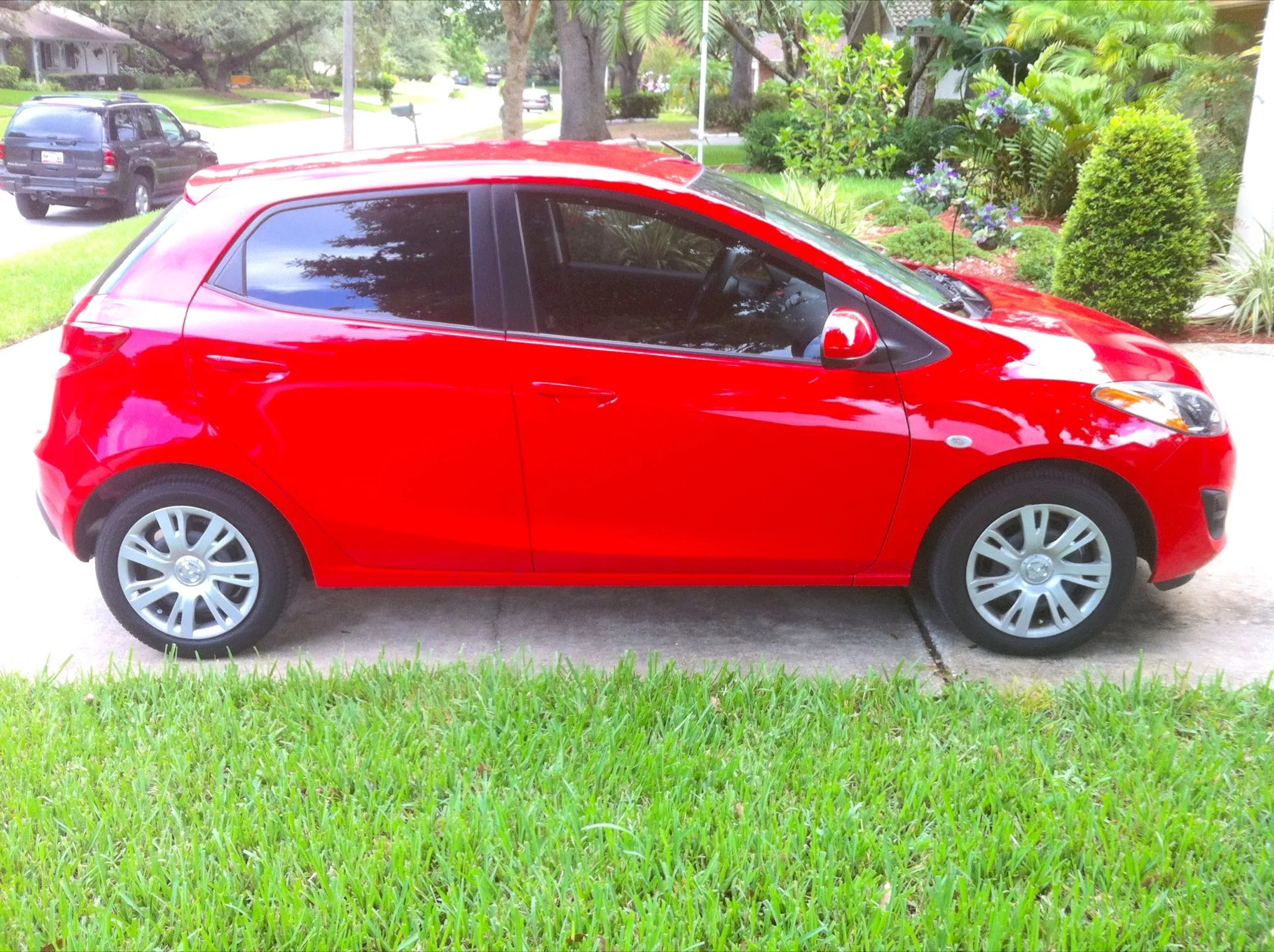

Hey everyone, I'm seriously considering Racing Beat springs. Any chance those of you who have them could post up some daytime photos looking straight at the side of your car so those of us out there considering them can really get a better sense of the ride height? Most of the photos in the thread here are a bit dark or are at low or side angles and make it difficult to tell. Thanks very much!
Here you go. I adjusted the contrast so you could see it better.
