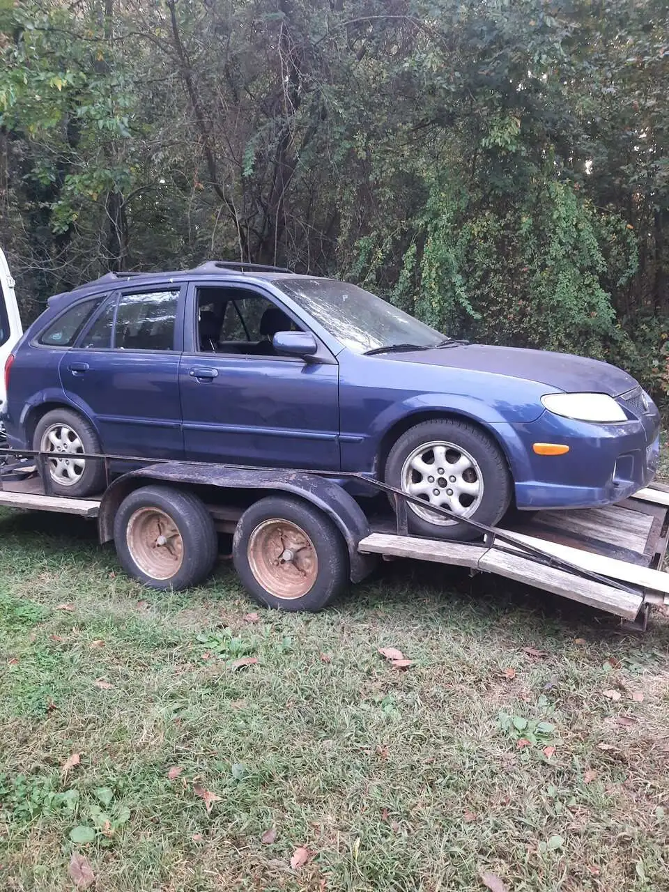

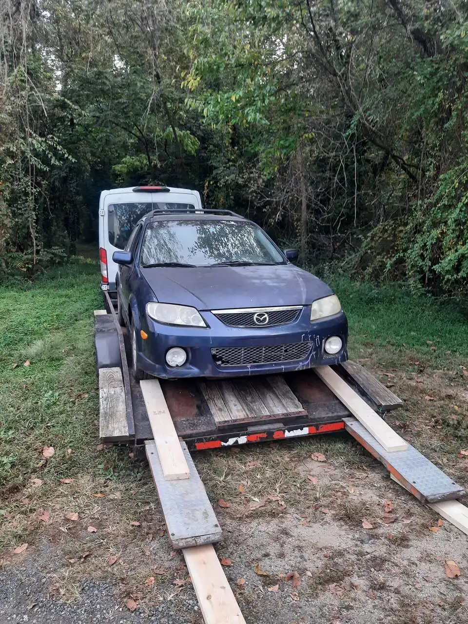

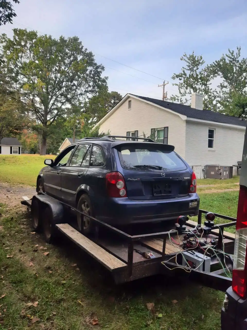

After building my son Carter's p5 and teaching him to drive it .... I decided I wanted one, but the one I found (white 02 with 275k) sold before I could get to it. I really liked the white too, but then I found a Dark blue 02 with 174k and a no start from a timing belt issue. Even better than that it came with another known good fsde and manual trans. Its just a question of weather I fix the timing ,swap to the other fsde or order a fsze to swap in like Carter's p5. So now I just have to wait on a title and order parts.

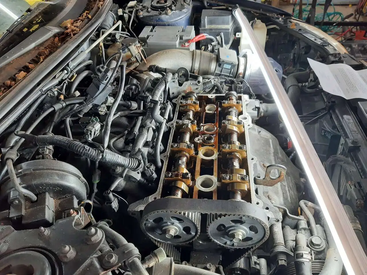

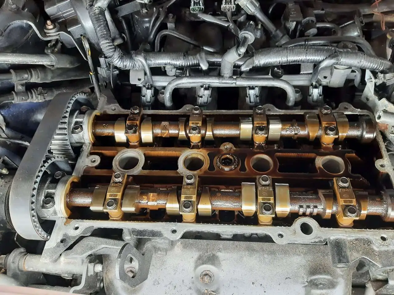

Yeah they seem to be . I finally dug into mine and found the intake cam 180 degrees out and the exhaust cam 15 degrees off. Not to mention that the reluctor on the crank was mangled and mangling the alternator belt. I timed it correctly, swapped on the old pulley from the other car, put in a power wheelchair battery from work (500cranking amps for free) and it started.
There is a ticking that I think is a collapsed lifter on number 1 cylinder that actully pumps up some and quiets down after warm up. After an oil flush and change I will see what it does determine if im going to replace with a ze like the other out of convenience or replace parts and drive it as is.

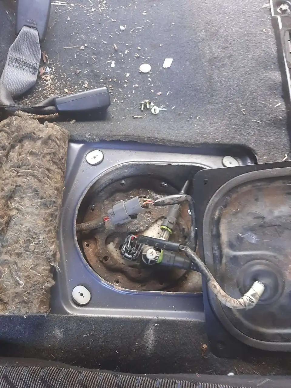

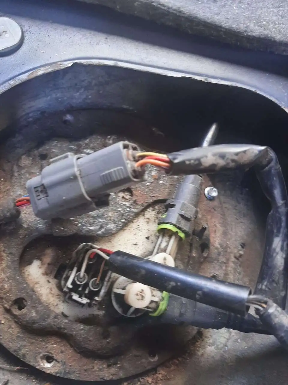

My old Protegé had that fuel issue. All the screws broke trying to get it out, too. I ended up drilling them all out and tapping for some bigger screws. Then used all stainless for any future servicing. (never needed to go back in there, but had peace of mind)

So the tank is completely fixable after much time and pondering. The engine..... for me to drive is not in the condition that fills me with confidence. I already have several taps and drills with replacement stainless hardware for the fuel tank. Then I of course started buying other parts now.
