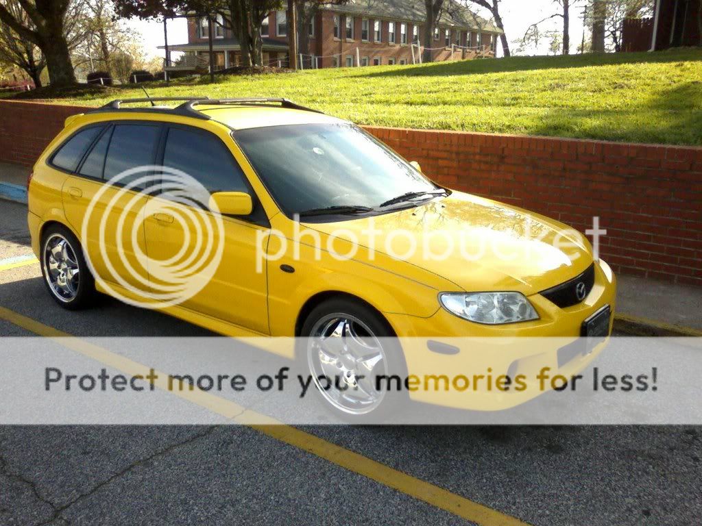

I know there are already a lot of threads with "post your wheels etc." I think we need a thread with only Protege 5 aftermarket wheel pics, so our members can have an idea of what would look good on their P5. So post you pics, include info like offset, tire size, suspension and wheels size. :D
this?
It's called wheel fitment because you buy the wheels and make them fit your car. Just roll your fenders and you will be fine

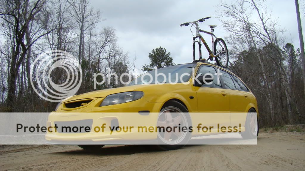

I have 205/50/16 on my p5 and I just dropped mine on BC coilovers on Tuesday and I'm not rubbing. I'm flush in the rear and I have 8mm spacers coming to flush up the front.

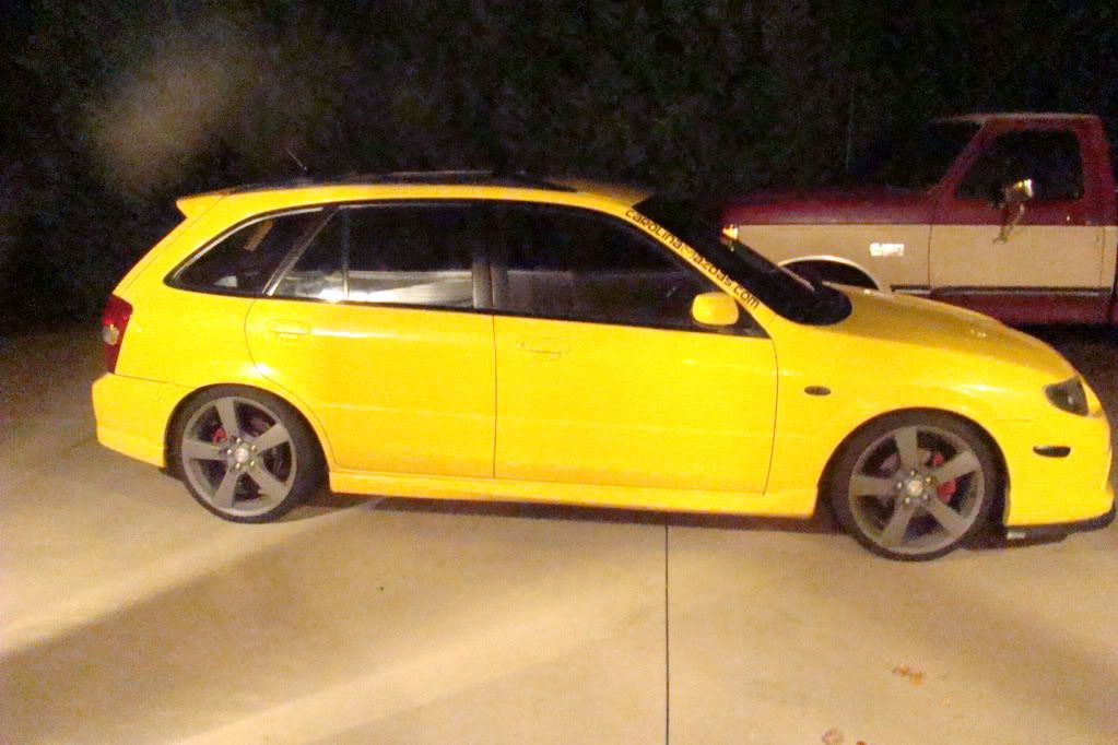

dang RX8 wheels...
ic 18x8 +50 doesn't really clear the fenders... looks sick though...
your fenders are rolled right?

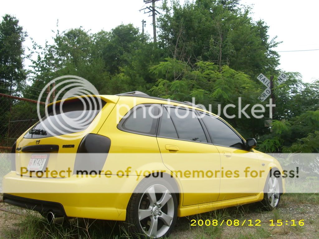

and to keep on subject... stock mazda3 wheels with 25mm spacer

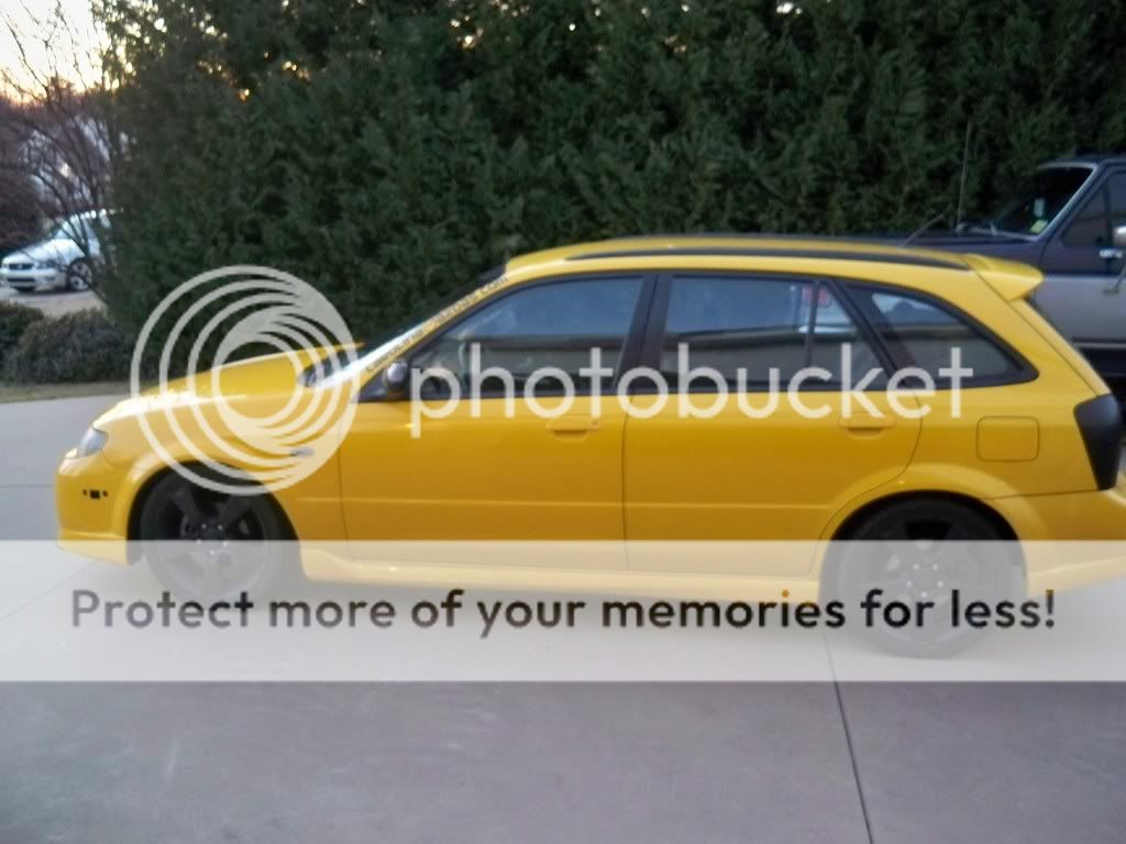

Oh yea, and that pic is before I put the 245's on the back as well, then I bent the rims, so that sucked...rears there are 205/35/18's...
DG??? Deals Gap???
Yes, Deals Gap. I'm from North Carolina :D Haven't been up there since...2006. Use to love going there, but then it got waaayyyyy too crowded with too many idiots and too many cops. Cherohala Skyway is much nicer IMO. A lot of roads to head to when it gets to thick at the Dragon. :D
