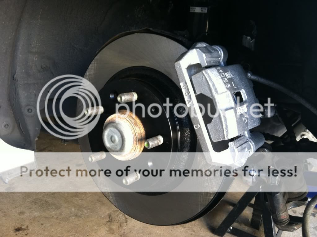

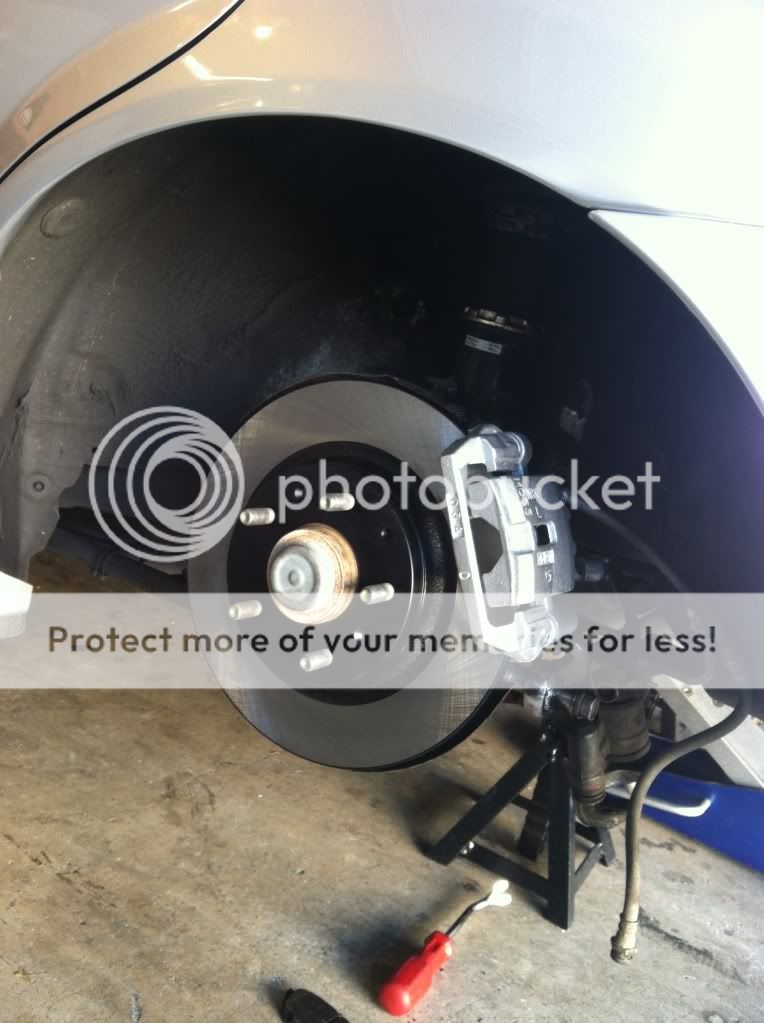

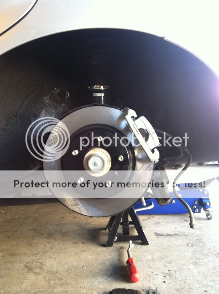

Update: I bolted on my 626 caliper and rotor today as a test fit. There were no rubbing issues. and the rotor spun freely. Some pics:
Hmm I wonder what I may have done wrong, or what parts I may not have properly had...
Good to know though, Looks great
