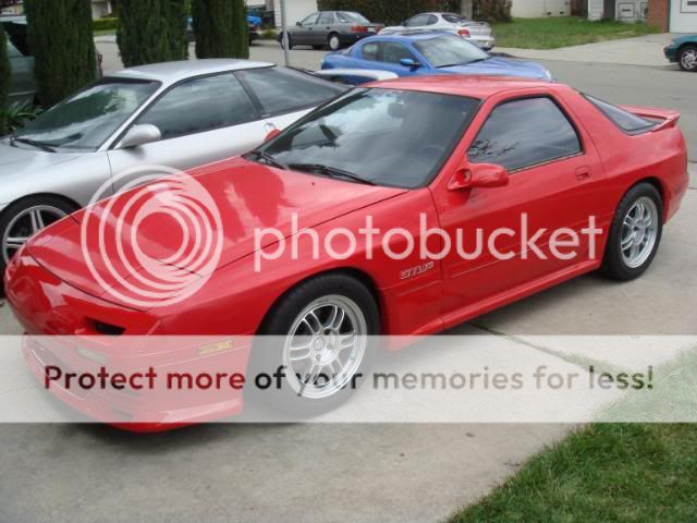

So something has really been bothering me lately. Did the GTUs and TurboII S5 models have sdifferent side skirts than the other models. When I look at some pictures, the side skirts seem to "stick out" a little further (ie, they have a little flare) and hang a little lower. Perhaps this was a later option? I just see some GTUs's and TurboII's and it looks like they have a body kity per se...
EDIT: Compare the pictures below to the similar angle I posted on the first page...
BTW, this is the same wheel/tire setup I am planning on running.
I think the only difference between say a GXL was the lighter chassis, no sunroof, better gearing ratio (5th i think), the stock rims are the same as the tii, (correct me if i'm wrong)

The tii didn't have different side skirts or front lip from any of the na cars. It may just be the angle of the pictures
Also the gtus gear box was the exact same as the other na's it was the rear end ratio that was different (4.3 as opposed to the 4.1) but your right about the wheels.
Ohh as a side note the only "stock sideskirt" was the aero kit add on that certain s4's got as an option. They were little rubber nubs towards the back corners (along with a metal undertray and I believe the sport duckbill wing which all lowered the coefficient of drag)
Maybe Mazda did a little refreshing after 1989 then? I don't know the year of the car in the picture I posted above but if you look at the moulding just below the "GTUs" decal and compare it to the same region on my car you'll see there is some difference. I know the S4's had an aero package option, but I keep reading conflicting information regarding an S5 aero option on the Turbo models (front lip and sides skirts as mentioned above). Mazdatrix sells the front lip as a factory Mazda part (with factory paint as well).
The car you posted is an S5. The moulding have the line in there offset. The S4 are down the middle. The lip on the car pictured looks like the Odura lip we sell.
