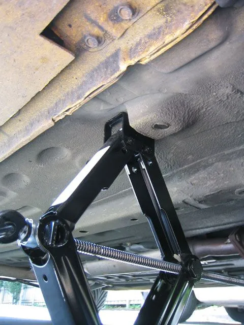

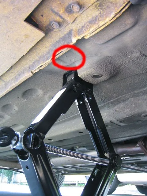

i got a few question beside the cause of the "bong", see the pic, did i get to the ring position to jack?

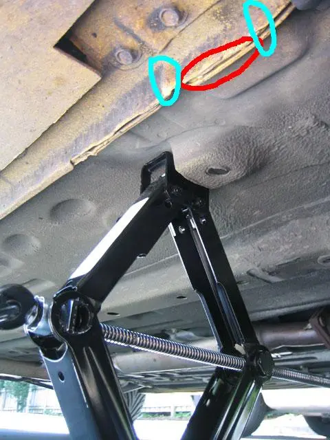

or should i jack inside the red circle or what?
the instruction on the jack or the manual doesn't really help. :(

I jack where the red circle is so it sits in the pocket and doesn't slide
what about jacking it on the yellow edge part? ive done it there and it hasnt done anything?
oh that's what I meant, jack on the vertical piece of metal

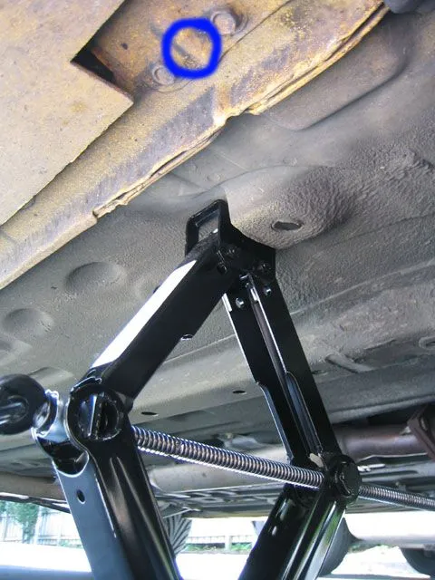

last time i tried jacking inside the blue circle, it squeaked a bit and left a mark there.
the instruction on manual/jack doesn't seem to work with sp20 since the side skirt probably covered the intended position?

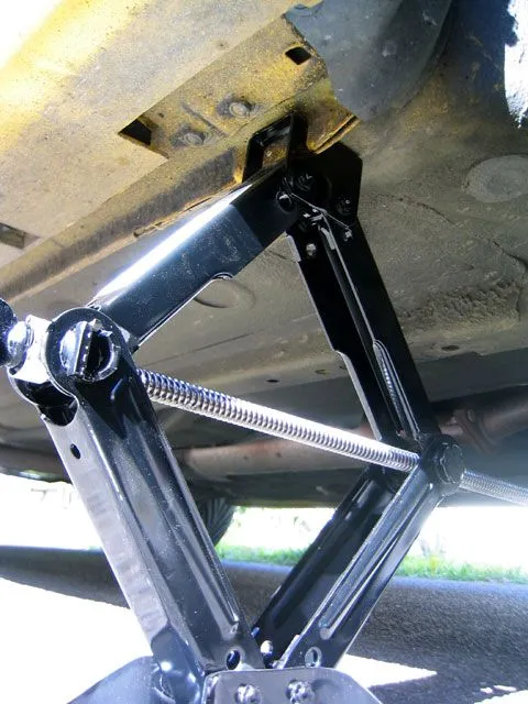

this is where i jack mine up usually...never done it anyother way and its worked with all my mazdas that i have owned...(93 mx6) but you guys mention other places, is this place right...im not sure? put the jack on the purple line or the yellow metal part?

yes that's what I'm talking about
the purple line
You fit the notch of the jack into that pinch weld that is circled in red on that 2nd picture.
