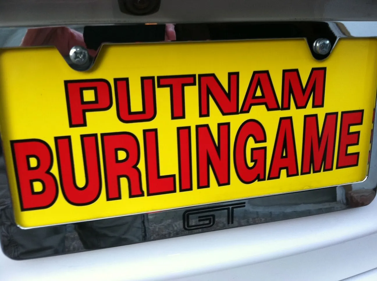

GT lic pl fr.JPGNot concerned, even though I do use a plate frame (GT).
FYI the official Mazda license plate frames come with an adhesive backed foam strip about 8" long that you put on the bottom of the license plate so it doesn't touch the car body. Also has round foam risers that you put behind the screw holes for the top part also.
It'll still wiggle and rattle because the license plate and plate frame touch, but it doesn't touch the car body.
