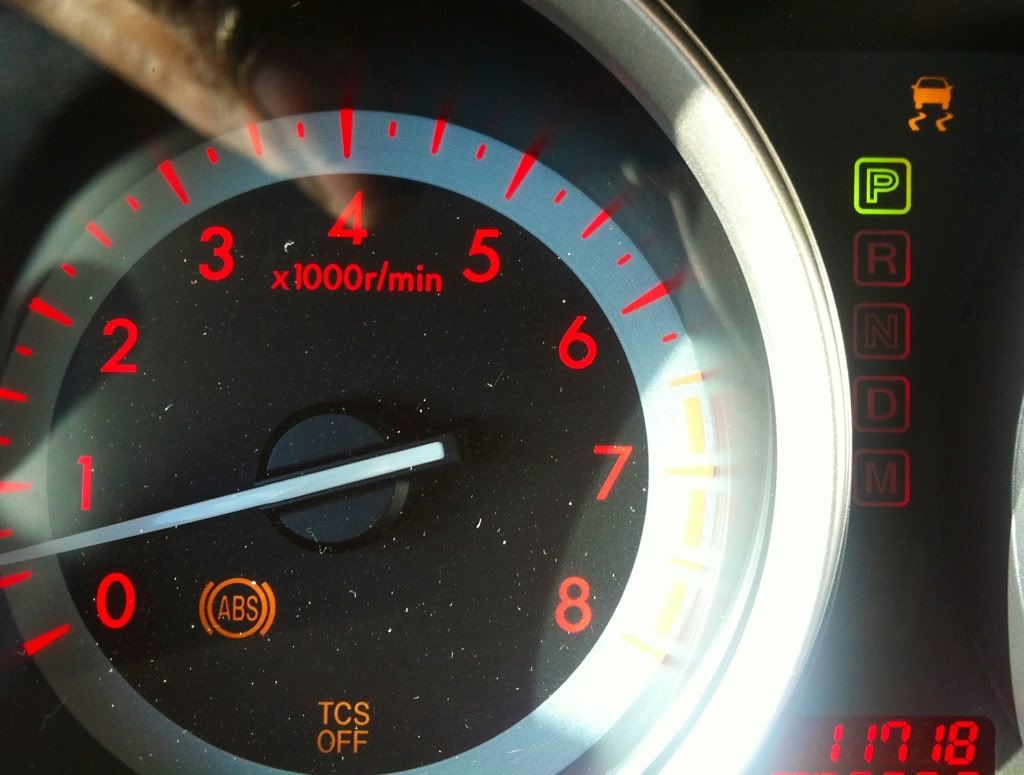

While driving normally on a dry road, the "traction light" (dunno correct term) turns on. I felt a little shake in the car then all three of these lights turned on. I thought maybe I had a flat and one wheel was not turning the same revolution as the others, thus the wheel sensors were picking this up. When I pulled over the tires were fine. I continued driving for a few miles and then the lights went away but then went back on after a few more miles.
The lights later went away and hasn't come on since. I later put more air in the tires...they were all around 31 psi. Any idea what might have caused these lights to come on? I plan on bringing the car to the dealer just in case.
You might not want to hear this, but it usually comes back again.
My guess is that the ABS sensor is going.
All three systems relies on the ABS sensor for inputs. Therefore, when ABS sensor is down,
all three lights lit up.
Hope for the best.
If your CX9 is close to warranty expiration date, visit a dealership to get the event logged
(probably error code read - should be stored in OBD-II still). In case this happens again
after warranty expires, you can still claim for warranty repair. Just my two cents.

Thanks for the insight.
I assume something like this would be covered under bumper-to-bumper warranty, which I still have. I'll update later on the diagnosis.
