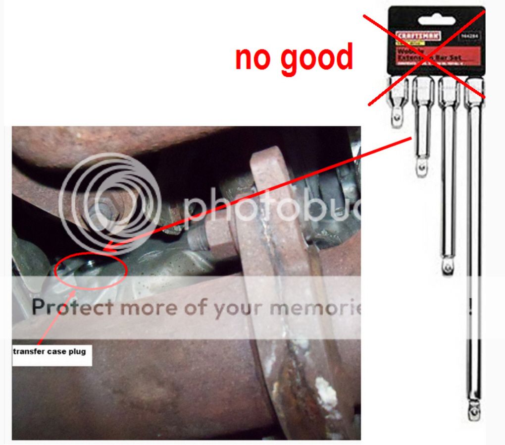

Also, forgot to mention, I checked today, there's absolutely no space for an extension bar,
only way to get to the transfer plug is to crossover the beam underneath from the rear with a stubby 3/8" drive ratchet.
The head of the 3/8" drive can just barely fit ! there is a metal plate on the opposite side of the 3/8" drive
we got lucky, if any more tighter, we wouldn't be able to get the plug out due to the stack up tolerance
of the loosened plug threads + ratchet head thickness
(the available space decreases with each loosening turn of the plug threads until the ratchet hits metal on the opposite side).

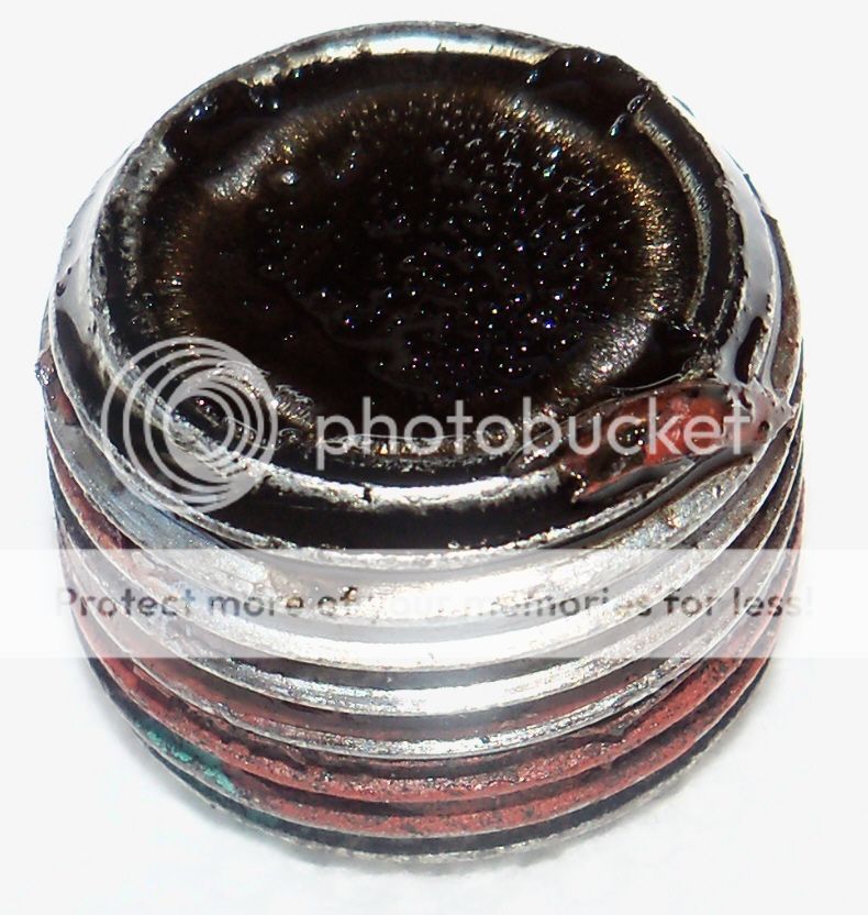

Here is a picture of the transfer case plug and Royal Purple 75W140 gear oil, no sludge !! just some small amount of metal particles as expected on the magnet. You can also see some of the VC-3 orange sealant came off during plug removal, I reapplied new VC-3 when I reinstalled the plug.

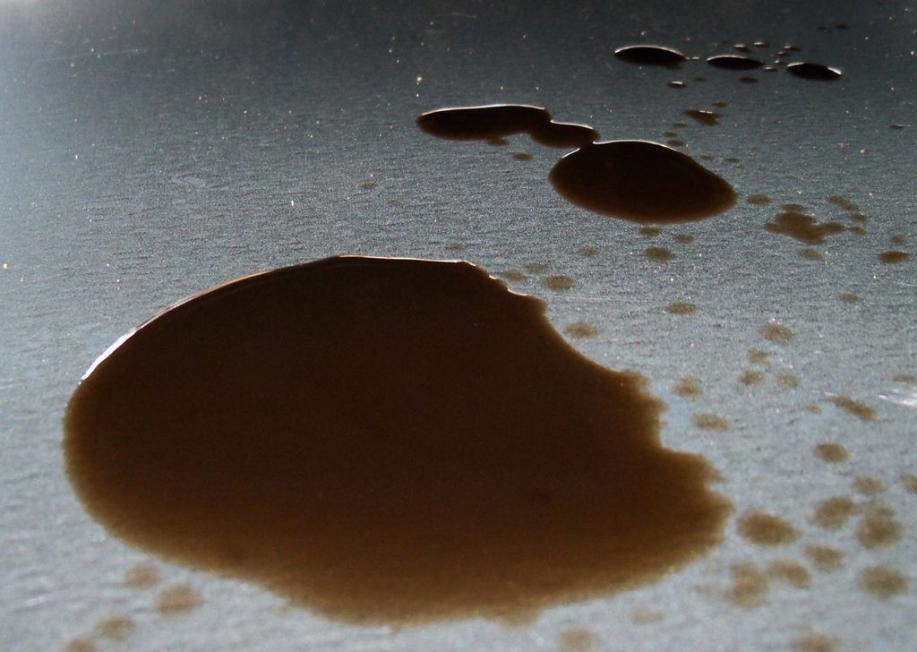

Here is video and picture of the used oil drippings, I highly recommend getting a large aluminum drip pan (I got mine at Walmart, they run about $12 but well worth it to catch the mess)
