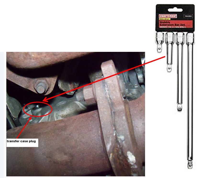

I think the hardest part was getting the plug loose for the first time, the space is really, really tight and you need to reach it from the back around a cross beam with a short stubby 3/8" square drive ratchet, you'll understand when you see it for yourself.
(note: counter-clockwise to loosen, and also very important when sealing plug: hand thread clockwise the first 2-3 threads after you are done filling with new oil just to make sure your are not cross-threaded before using the ratchet to really tighten the plug) ,
I had an "a-ha moment" after I did the oil change last week, so I will try this next time: I actually think a 3/8" extension will work but I've never tried it, maybe another member who has done the procedure can chime in and confirm it. Instead of reaching around, is it possible to get to the plug with a short 3/8" extension from the transfer case side facing the passenger seat perpendicular to the plug ? need to offset with the extension bar because the U-pipe is right underneath and gets in the way of the ratchet handle.
this will make it really easy to loosen and tighten the plug, no more reaching around with the stubby ratchet
(it's really difficult to have your whole arm reach around and stretched and get enough torque to loosen and also tighten)
