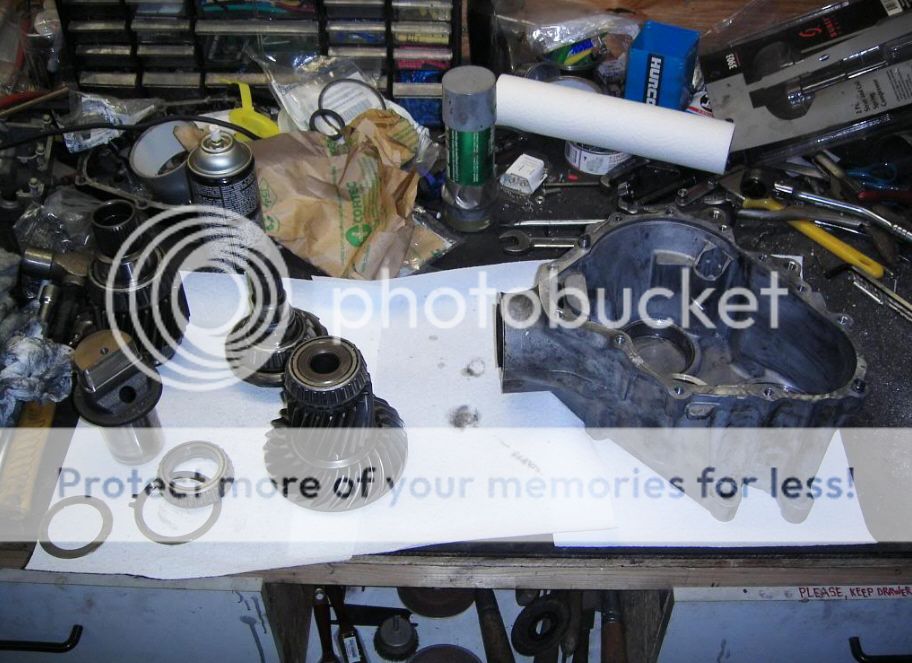

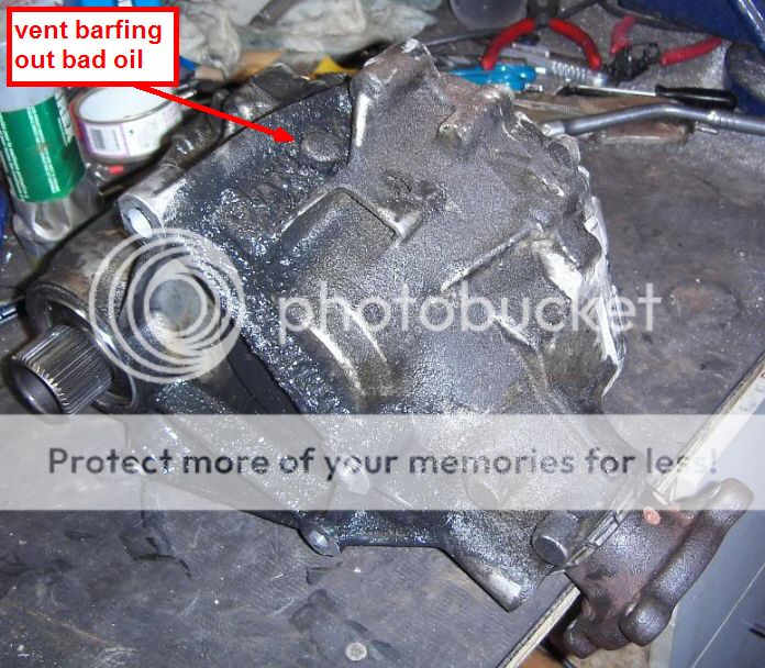

this is from Ford Edge forum (transfer case issues)
http://www.fordedgeforum.com/topic/10914-ptu-leak-failures/page-2
the Ford Edge has the same exact transfer case as the CX-9, when you start smelling burning oil or see leaking oil,
DO NOT IGNORE IT! , you can still "save" the transfer case by changing out the oil. If not addressed, the TC will be damaged beyond repair or even worse take out the transmission with it as some members have reported
below is a picture from the Ford Edge forum, the oil has broken down and is "barfing" out thru the vent valve on top:
Ford Edge new oil looks to be amber/yellow:
Those Ford Edge guys are true gearheads, I bow to them, they took the whole darn transfer case apart !
