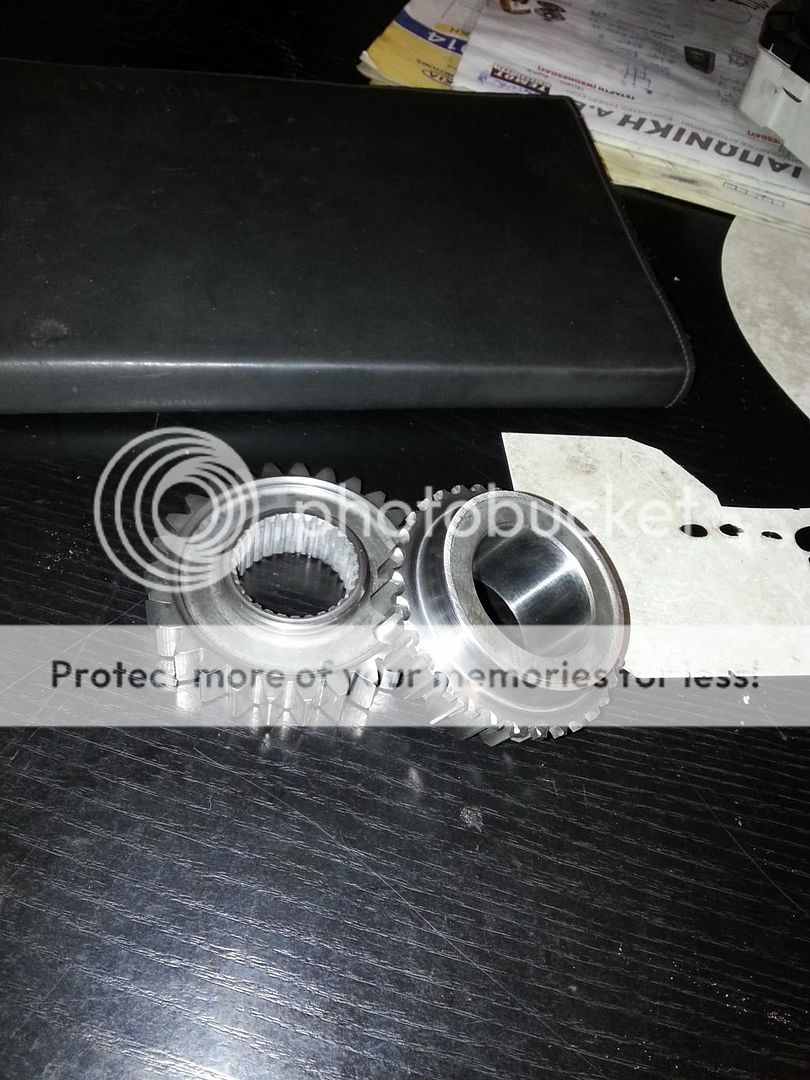

Today I just got on my hands the new custom 3rd gear, Straight cut.

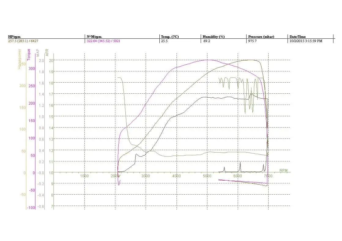

After some time I finally got on the dyno.
The results impressed me to be honest.
On wastegate pressure 0.75bar I got 215whp (242hp + 29kgm of torque on flywheel) and with 1.35bar I got 258whp(283hp on flywheel) with 34kgm of torque
Here is the dyno plot at 1.35 bar.(I am requesting this pressure after 4800 until the redline to avoid torque on low rpms)

Wow. That's a lot more power than I expected. Awesome!
I haven't read your whole thread...is this a stock bottom-end?
Mike

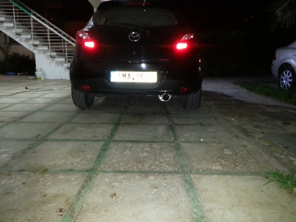

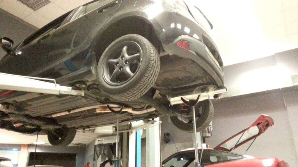

Finally I got me exhaust upgraded.
The setup that I had from the beginning of the turbo project was 2.5" downpipe until under the front seats and the rest was my ehxaust that I had from the N/A setup which was 1.97". The new setup is 2.5" downpipe until the front subframe and 2.75" the rest.
One think that surprised me was that the car spooled much faster(200rpms down). I couldn't believe that because the turbo was already maxed out at 1.35 bar. I was so curious that i hit the dyno today and the car on wastegate pressure gained 10hp(250 at the crank, 240 before) but at full boost the numbers were exactly the same(285 at the crank).
I also did a vid but me phone couldn't keep up with the exhaust (naughty)
