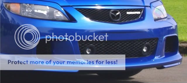

Laser Blue, what rims are those? also, how in the world did you make that center grill piece with the fogs?
Id buy it from you :D
The rims are from an '07 Miata. 17" X 7" X 55mm offset, just like the stock RH's. Installed over new wheel studs and 10mm Ichiba hubcentric spacers and held on by Dorman Blue anodized extended lugnuts.
The fogs are eBay halogen fogs, converted to 3500k HID. They are mounted to the bumper reinforcement bar. The grille was cut let the fogs through and I made the trim rings from satin gloss plexiglass. They're wired to a P5 fog harness and relay with an oem P5 switch in the dash. Glad you like them!
