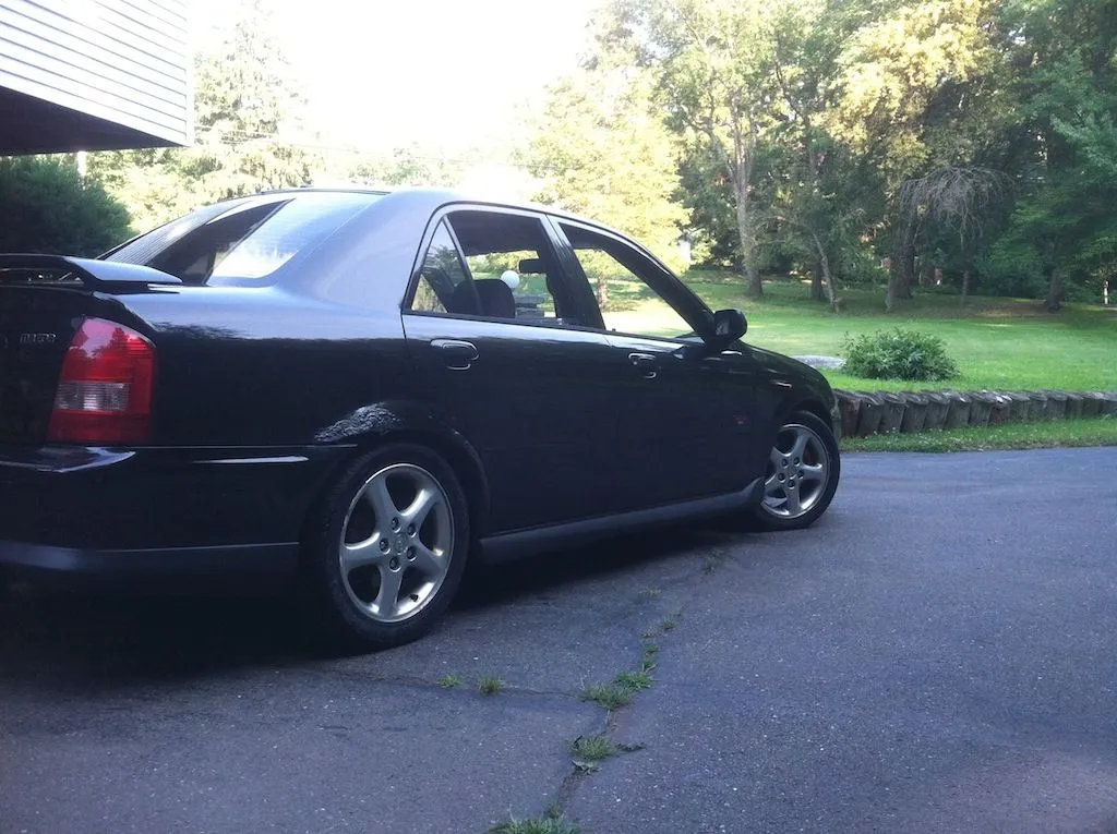

so, here they are... (don't mind the condition of the car)
so far, they ride well. comparing to the 215/45's on the FD wheels, they have decent response. ride well, good handling, responsive enough.

i have the tokico HP handling kit. the front could stand be a touch lower, but i think it looks ok.
