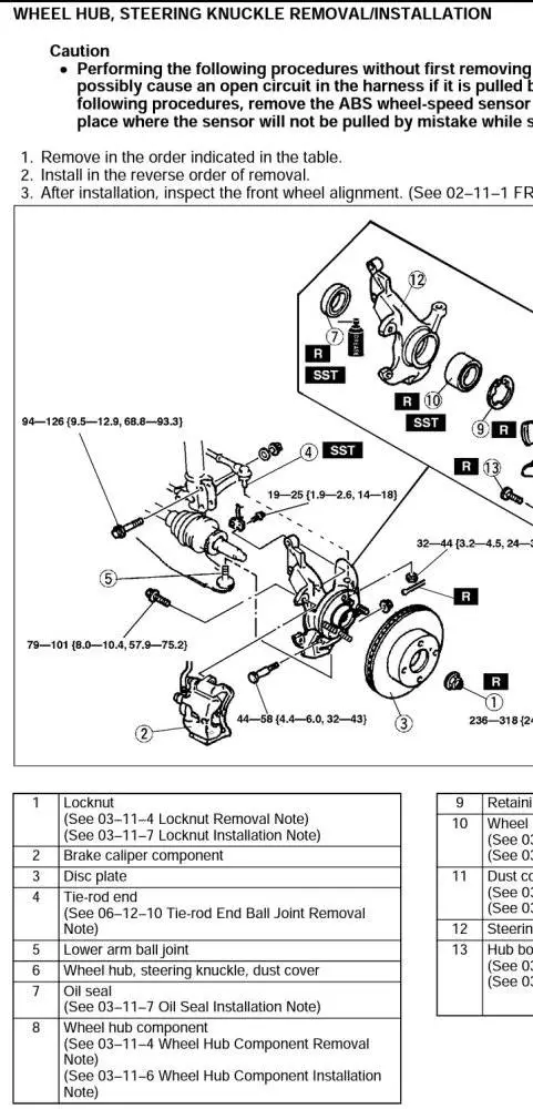

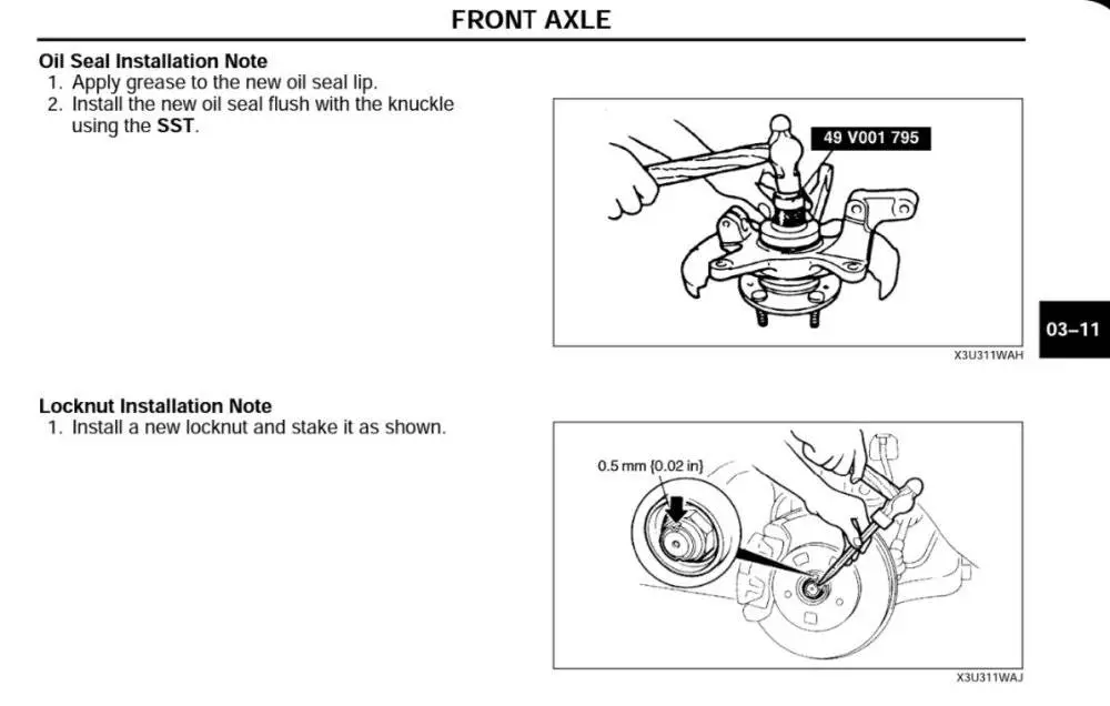

And get rid of the "oil seal" if you've got one.
They don't work and Mazda deleted them from later models.
They were supposed to keep water and dirt from getting into the hub, but they ended up leaking and sealing water into the hub where it would get into the bearing and rust it out.
Thanks, I remember the seal debate but couldn't find it. After reading your post, I was able to find the TSB here.
The TSB only applies to certain 2001s and mine is a 2003, but, it does say that the seal was deleted for later models. One curious thing, however, is that the 2002 service manual that's floating around does show the seal. According to the TSB, it shouldn't for a 2002. I'm going to wager a guess that the design changed but the manual wasn't updated.

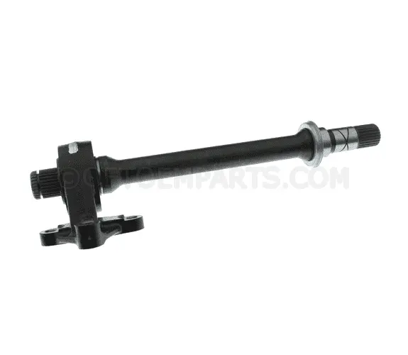

There is a bearing and seal in there that you can change without buying the whole thing.
Boy, I had to dig into the manual to find that. The joint shaft looks to be the intermediate drive shaft between the trans and the RH CV joint. The noise I'm hearing is seems to be on the LH side too and this is on the RH shaft.
I'm not finding it listed at all, at least at Rock Auto or Autozone (searched joint shaft and intermediate shaft), let alone just the bearing. I'll look more tomorrow, it's time to get off the computer for the night, lol.

For a 2004 Mazda3 joint shaft, which may be the same parts, or it may be completely different, the bearing has an NTN part number of 6206ZZC4. The seals are part numbers G56025744 and G00325742A.
At least that will get you on the right track.
