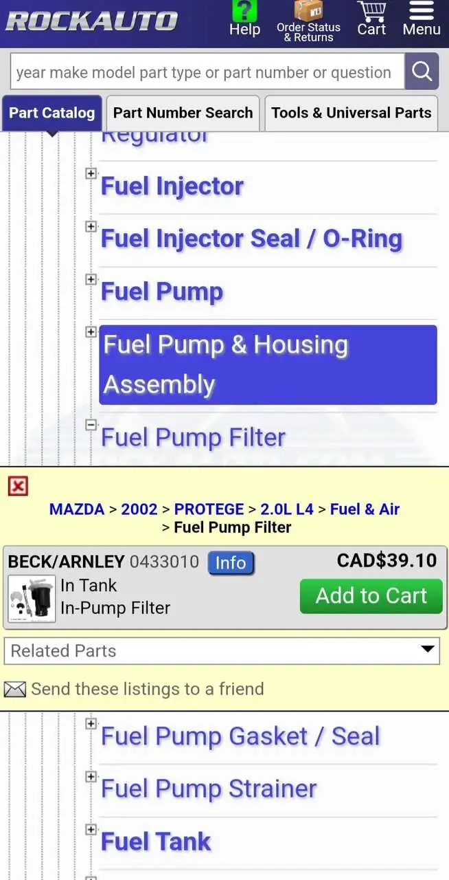

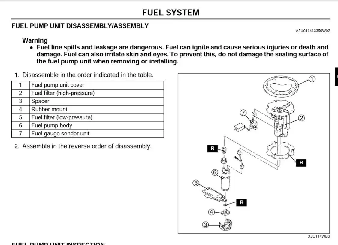

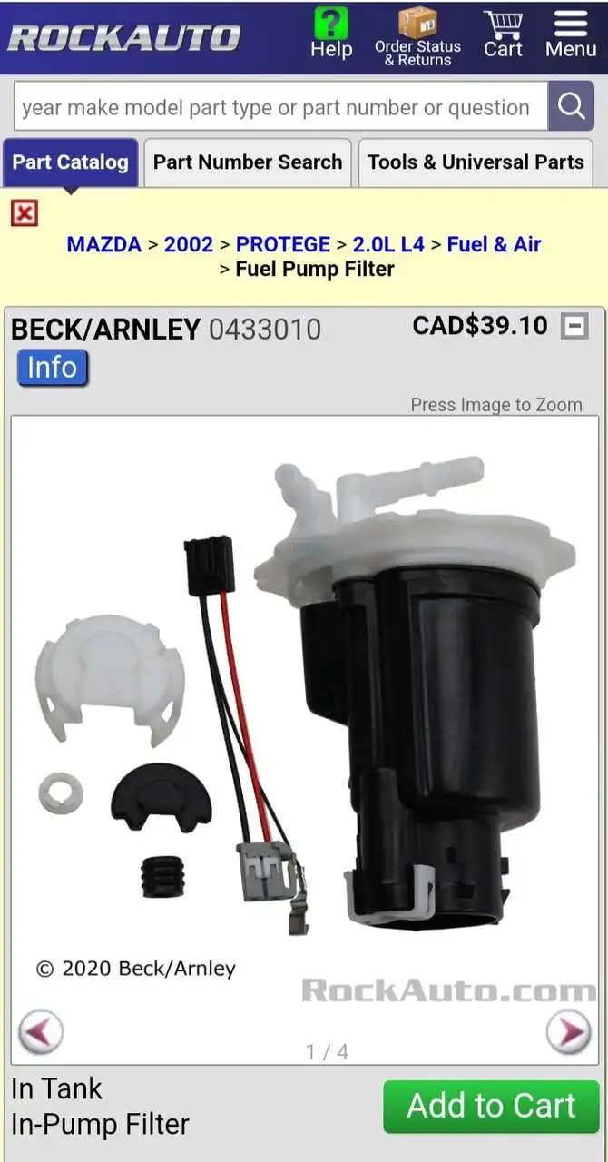

However, a couple weeks ago on Wednesday, there was a small amount of hesitation. About 5 minutes later, there was a rather scary bit of hesitation. I made it home. I did some research, and thought it's probably something with the fuel system. Since the Mazda Protege doesn't have a separate fuel filter, I speculated it could be the fuel pump that was starting to go.
