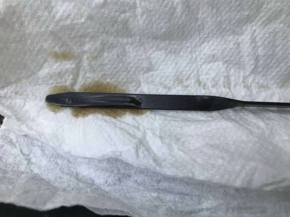

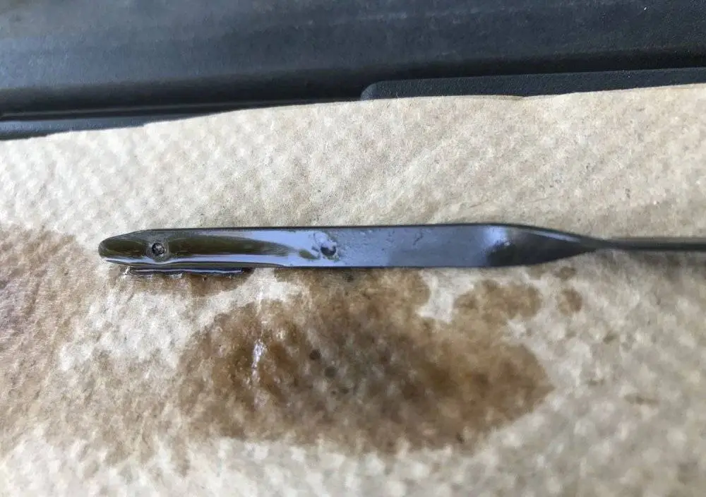

The truth is, the oil level showed on the dipstick will be almost the same whether you check it when the engibe is warm, or the engine is cold. You can do it either way you prefer. It’s been proven on my 2.5L. But checking the oil level the first thing in the morning before the engine start is so much easier to see the oil on the dipstick; and just one pull、no wiping required.
Hot:
Cold:
