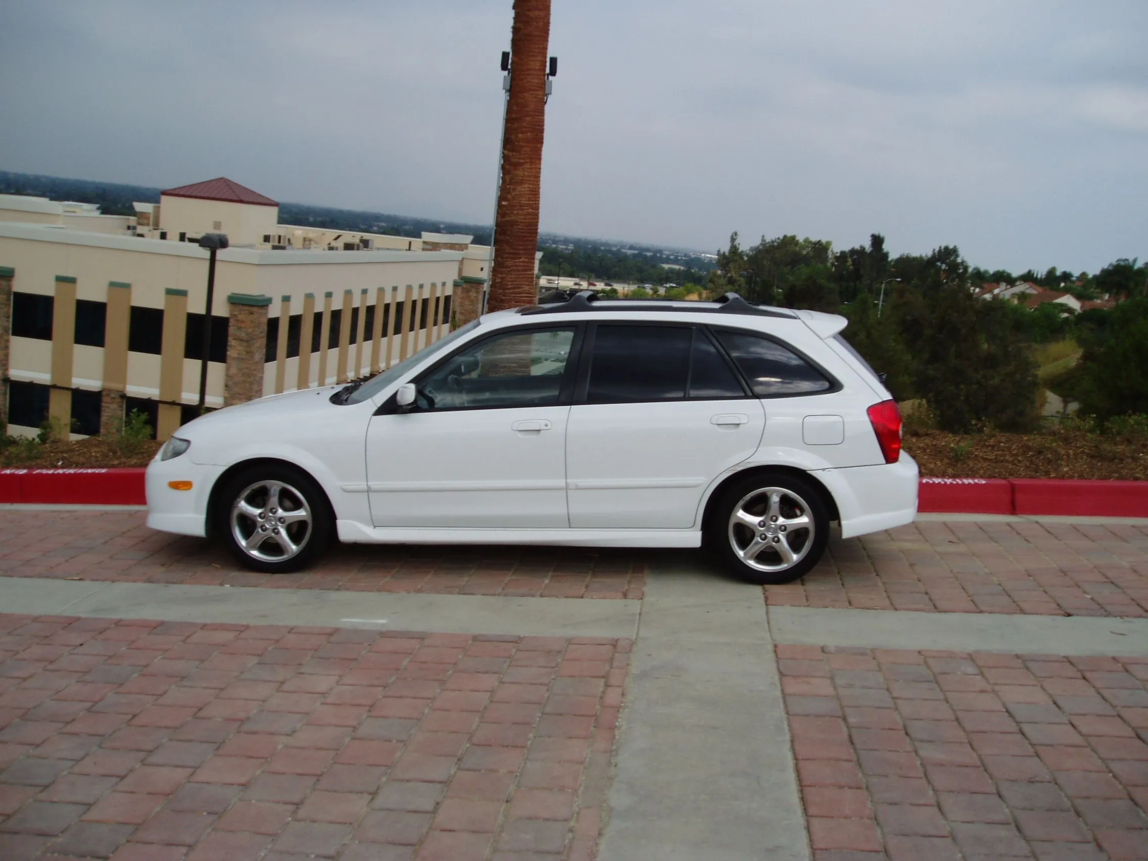

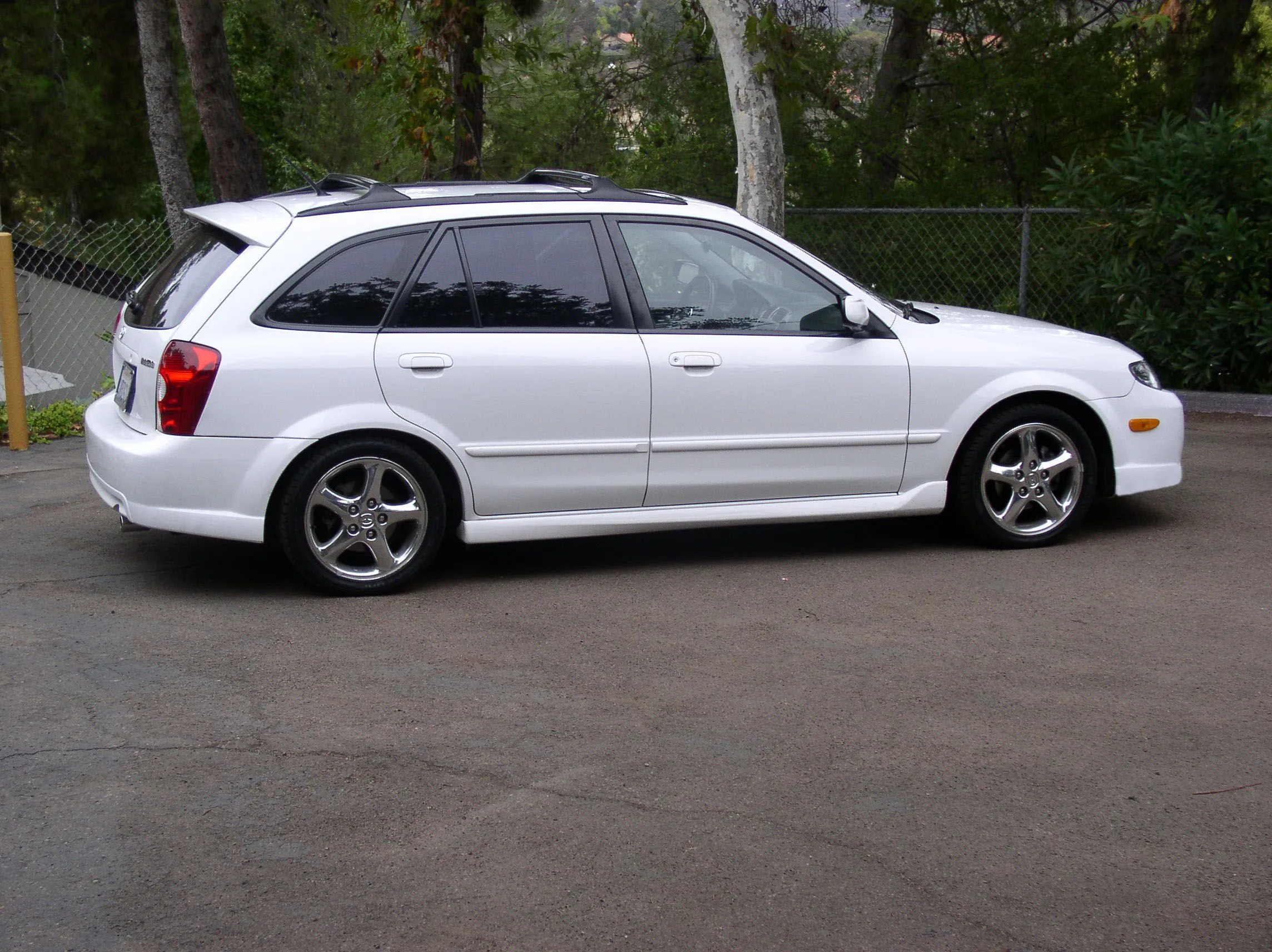

Here's a pic of my car with just the MP3 springs and stock everything else.

If you don't mind the front wheel gap (more in the front than rear) they are worth it. I noticed a big change in handling when I added them. Less body roll and more stability at higher speeds.
dont do this drop...its a waste IMO....if you cant tell from the pictures shown...the back drops more than in the front and it looks retarded with your front end sitting higher than the rear...almost as if you have hyrdaulics and you front is raised up with oout the rear being raised....
i have seen it it person and IMO it looks like ass.....go with something that will give you a decent drop....and not make ur car look like a dumb ricer POS.

LOL dumb ricer POS huh? Gotta disagree with you on that one.
I was nervous about lowering my car at first so I went with these. They are good for people who aren't into the harsher ride you get with a lowered car, as the ride is still comfortable and the handling is improved. I will be going with more aggressive springs when I get new struts, but I wouldn't say these are inferior springs.
