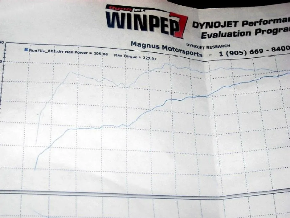

So Zigger went to Magnus Motorsports to get tuned. He's got the CPE TBE w/ cat, an ETS TMIC, and AEM CAI. 295 whp and 328 wtq. AFAIK those are the highest numbers on the stock turbo. The story is, he went for one session (270 whp) and they were pulling so much fuel (-24 in the Standback) at the top that they knew something had to be wrong. They checked the ETS TMIC and it was leaking in 5 places. He went back two days later and had it rewelded and put down 295/328.
He's out of town but asked me to post it.

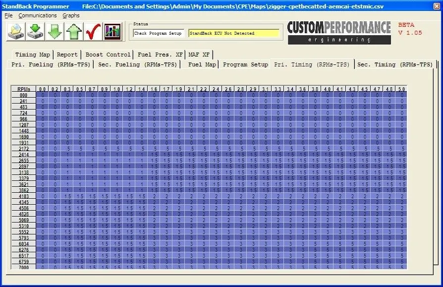

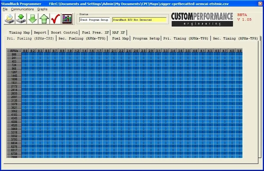

He's running 18.1 psi and, looking at the tune, they added fuel from 3500 to 4200 kept it stock from there and did most of the work on the timing, advancing it 1-3 in the standback. He's in Canada so it's tuned on 94 octane.

Hey man.. Thanks for posting I wont be around until Sunday but yeah I was pushing 242 whp with a broken BOV and 5 leaks in my TMIC guys check for LEAKS!! We made the tune sooo agresive and took fulel out at the top becuase it was rich as **** (because of boost leak)and finaly hit 270 whp not safely finally we Fixed the Boost leaks got a new BOV retuned everything and got close to 300 whp 330 t/q The car is insane!!!
It's abit more than 350 crank but screw that look at the TQ!! 330 t/q at wheels..

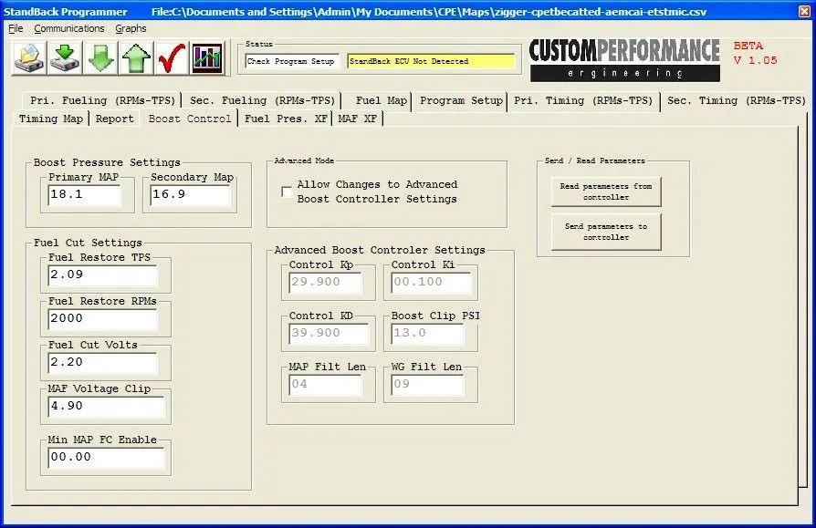

That's a really good question. It looks to me like they didn't do much tuning with the fuel, it was mostly timing. His boost was set at 18 psi which is pretty much maxing the stock turbo.
Here are the screenshots of his tune.

To LBV I checked my TMIC he mentioned there was a member that has a issue with one and when I ran him with his almost stock speed 6 Vs my Tuned 3" TBE with TMIC speed 6 and kept up pretty close to me I knew something was wrong. Believe it or not your butt dyno wont feel it . But a dynojet showed a increase of 57 whp and 62 lbs feet of t/q!!! Now I inhialate a speed 6 with a exhaust I ran 2 buddies already and it was uuugly
